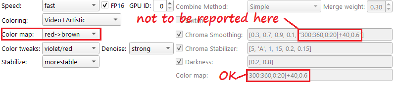

  VERY IMPORTANT: when is assigned the preset Color map, its value must be reported in the custom section ONLY on the field Color map (see picture below)
[Image: attachment.php?aid=2893]
