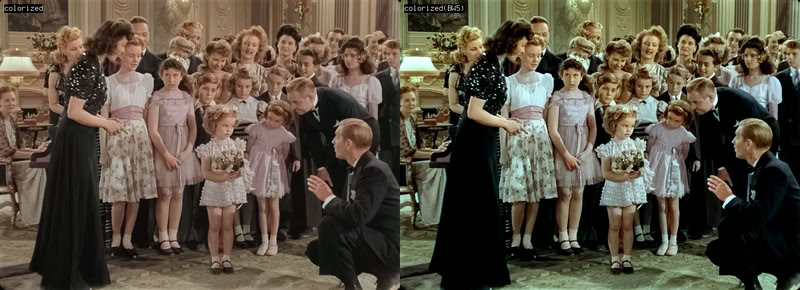

   I was finally able to apply in HAVC some of color adjustment filters that I developed in Vapoursynth described is this post: New AutoColor adjustment filter
   The results are satisfactory as you can see in the picture below
       [Image: attachment.php?aid=3266]
   With the previous version (image on the left) the colors were dull with a majority of "rose" color (the color of skin), with the new version (image on the right) both problems has been solved.
   To reduce the impact on GUI I recycled the parameter BlackWhiteTune, which now can have the following values:
:param BlackWhiteTune:      This parameter allows to improve contrast and luminosity of frames colored with HAVC.                             Allowed values are:                                     'None' (default)                                     'Light',                                     'Medium',                                     'Strong'                                     'Light+Custom',                                     'Medium+Custom',                                     'Strong+Custom'                                     'Light+Restore',                                     'Medium+Restore',                                     'Strong+Restore'
  In the GUI is also necessary to add the following new parameter (a numeric combo-box):
:param BlackWhiteMode:      Method used by BlackWhiteTune to perform colors adjustments.                              Allowed values are:                                       0 : Apply Contrast Limited Adaptive Histogram Equalization on Luma                                       1 : Apply simple Histogram Equalization on all RGB channels                                       2 : Apply CLAHE on all RGB channels                                       3 : method=0 and method=1 are merged                                       4 : Automatic brightness and contrast optimization with ScaleAbs                                       5 : Auto brigh and contrast optim. with saturation arithmetic (default)
I attached the RC1 of new version 5.5.0 and a sample containing the new colorization cases introduced by the new/changed parameters
