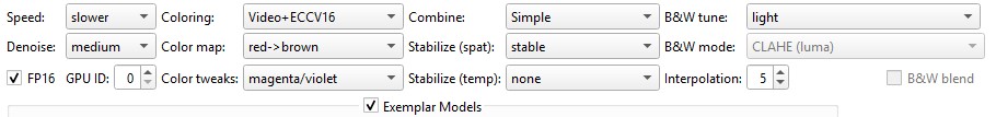

  Regarding the GUI I would prefer something more similar to the old one, like this
  [Image: attachment.php?aid=3292]

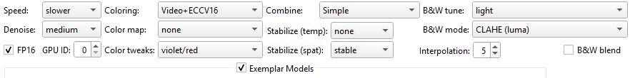

Sorry for this, I didn't expect to find a solution, but I finally did.  Angel
[Image: attachment.php?aid=3293]
Please look also to my suggestion on GUI widgets arrangement.
