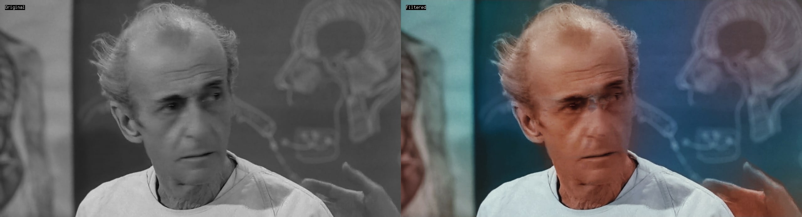

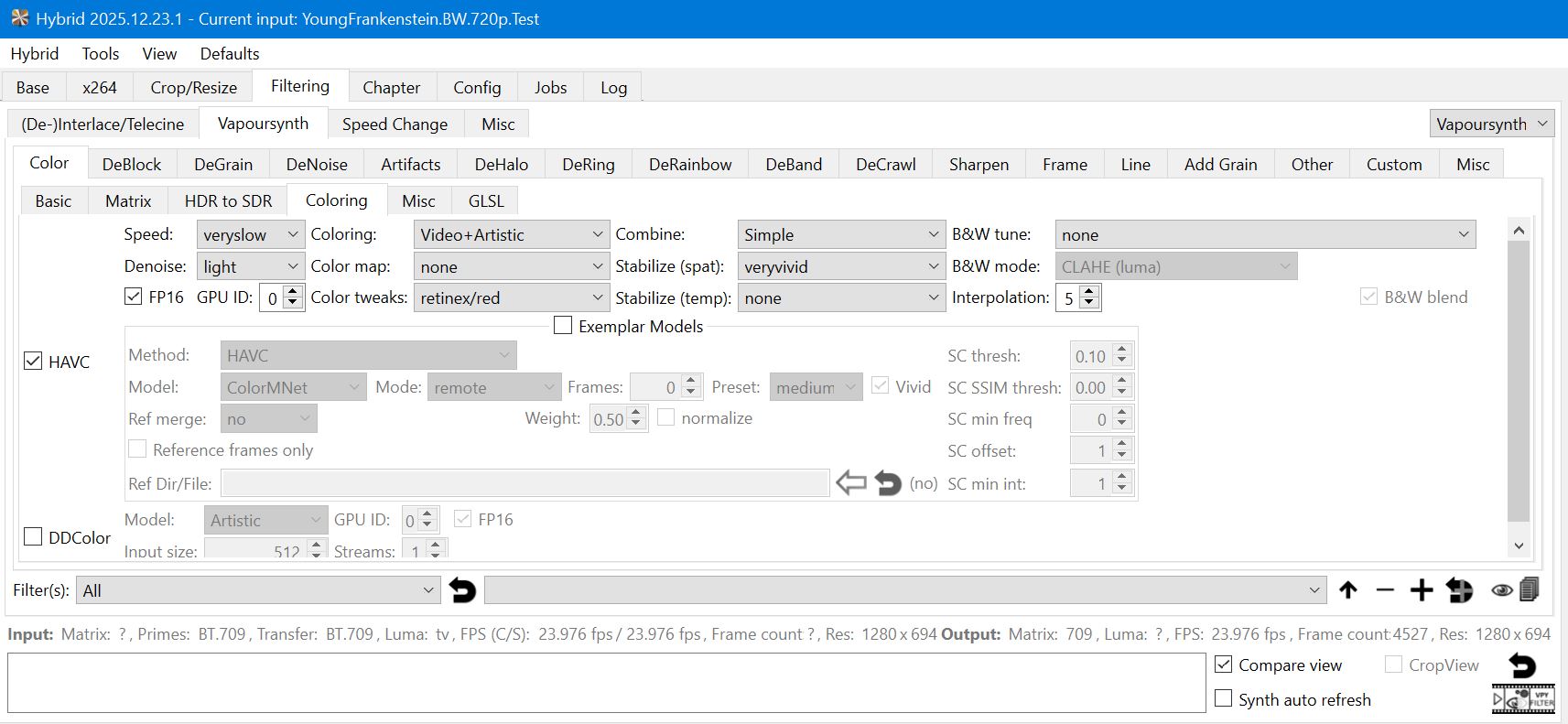

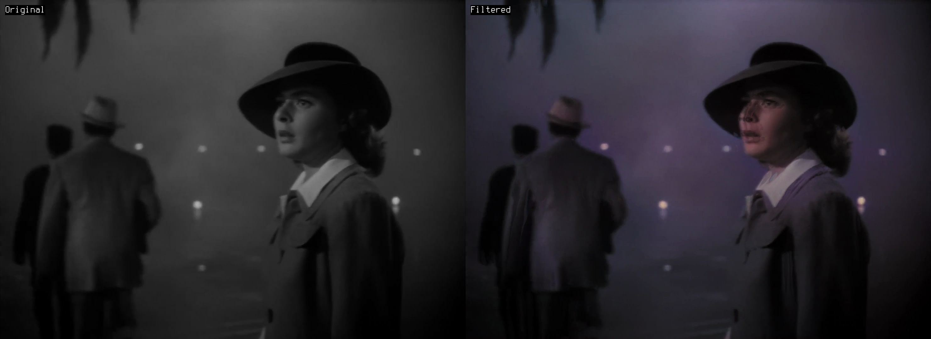

Thank you Dan & Selur for helping.  I cleaned install the latest Hybrid and unfortunately the distortions are still there.
This time using Dan clips of the Casablanca Trailer Frame 2706 and Young Frankenstein test clip of Frame 2012 and 2836.
These video clips I've uploaded here:
https://gofile.io/d/zRen81
The setting as shown in the pics.  The distortions appear when Stabilize temp is enabled or when Color Tweaks retinex/red is chosen or when Exemplar Model is enabled.
These type of distortions appear most noticeably on fast motions.
I was wondering if these distortions are unique only to my computer, maybe something got corrupted.  On Dan's machine they don't appear.
I am hoping that other users can run this test on these frames to see if the also have these distortions.  Thank you.
