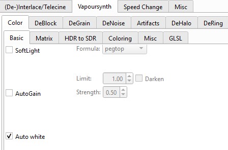

In Hybrid there is the filter "Auto white" (see picture)
[Image: attachment.php?aid=3482]
You should apply it to the orginal clip before merging the clip with the HAVC colored clip.
Otherwise you can try the Example 6: Direct application of filter B&W tune with some colors final adjustment
You can find it at page 114 of HAVC User Guide.
Try to play with the parameters strength and gamma of function HAVC_adjust_rgb().
