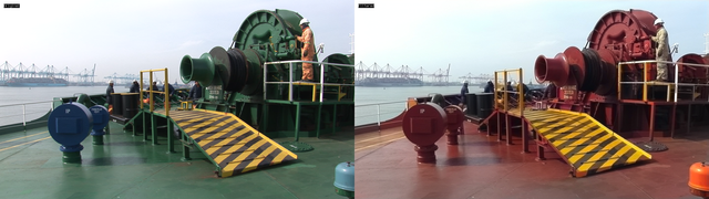

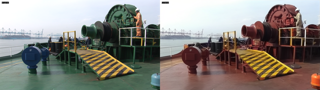

the coloring does cause chroma bleeding
adding BleedOut helps a bit:

Quote:BleedOuts is VSGAN filter ?,
.pth for VSGAN, .onnx for VSMLRT
Quote: don't knowing the original colors I cannot say if green is worse than brown, maybe in this context yes, but maybe in other context not.
left side is the original colors,... Smile
the color bleeding around the railing&co comes from the coloring and I wonder why. On clean clips there shouldn't really be a reason for color bleeding,...
