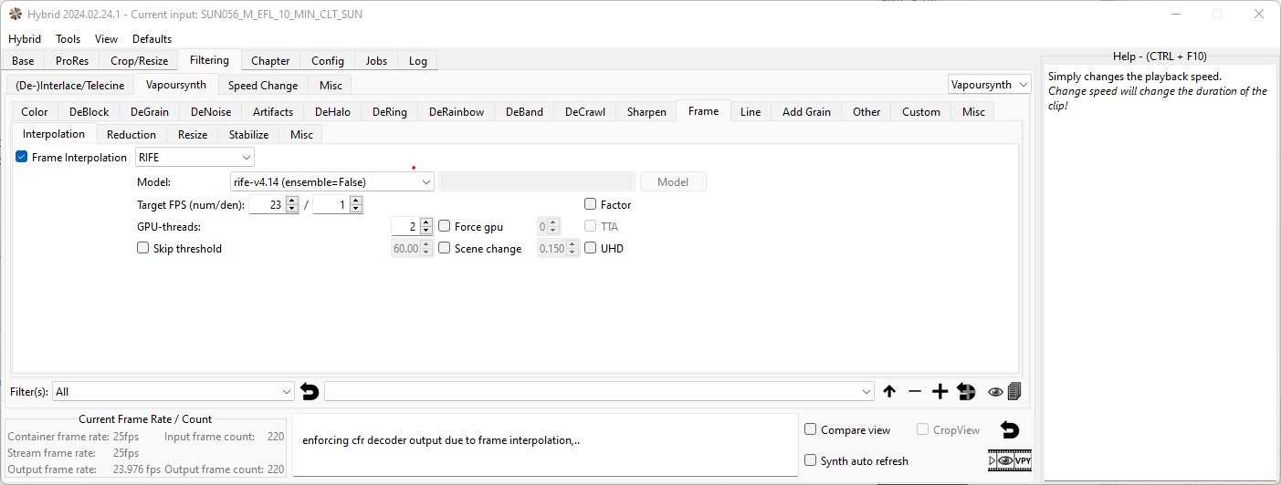

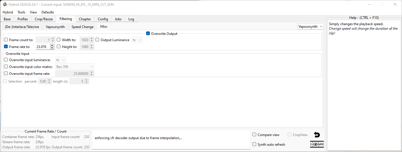

Is it possible to enter non-integer values into RIFE? I have managed it with other softwares but Hybrid seems to lock me out of using the '.'. I am attempting to have my footage interpolated to the TV standard 23.976. I can force it in the 'MISC' tab but this causes a conflict with RIFE and fails the render.

(using Filtering->Misc->Overwrite will not influence RIFE)

At the moment, if I don't overwrite the frame rate with the 'Overwrite Output' settings under 'MISC', the script fails. Is that expected behaviour? The Current Frame Rate box at the bottom does not change with RIFE enabled too

LOL, looking at the screenshot, you are using a 25fps source and you want to go to 23.976 => RIFE is for adding frames not removing. Smile
Since the frame rate RIFE is fed with is below the current frame rate there is nothing for RIFE to do so the output frame rate won't change. Smile
