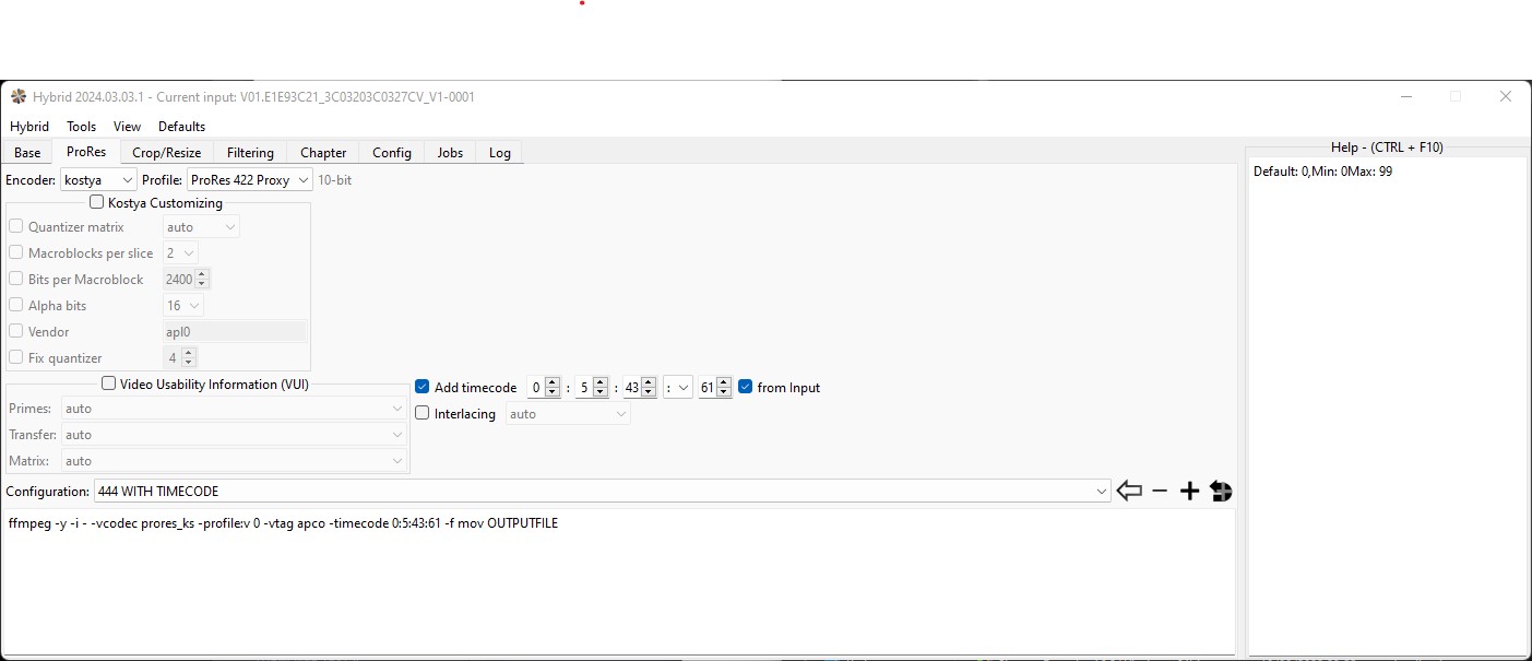

Hi Selur,
I've noticed that Hybrid is reading some timecodes from footage differently to how Davinci Resolve or Media Info might do so
I have a 29.97 clip that Mediainfo and Resolve reads the start timecode as
00:05:43:08
Hybrid reads it as
00:05:43.610 (I'm guessing the final number is in msec rather than frames)
Problem is that when injecting timecode into the ProRes on the 'ProRes' tab, it's reading as
0:5:43:61
Is there a way to improve the timecode reading/stamping on my clips? My hope is to take the standards converted clips from Hybrid and re-conform back in Resolve as close as possible using the original timecode
Thanks
James
