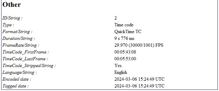

I've noticed that Hybrid is reading some timecodes from footage differently to how Davinci Resolve or Media Info might do so
I have a 29.97 clip that Mediainfo and Resolve reads the start timecode as
00:05:43:08
Hybrid reads it as
00:05:43.610 (I'm guessing the final number is in msec rather than frames)
Problem is that when injecting timecode into the ProRes on the 'ProRes' tab, it's reading as
0:5:43:61
Is there a way to improve the timecode reading/stamping on my clips? My hope is to take the standards converted clips from Hybrid and re-conform back in Resolve as close as possible using the original timecode

Ah, okay I see the problem.
MediaInfo reports:
Video Count : 391 Count of stream of this kind : 1 Kind of stream : Video Kind of stream : Video Stream identifier : 0 StreamOrder : 0 ID : 1 ID : 1 Format : VC-3 Format : VC-3 Commercial name : DNxHD 220x Commercial name : DNxHD 220x Format version : Version 1 Format profile : HD@HQX Codec ID : AVdn Codec ID/Info : Avid DNxHD Codec ID/Url : http://www.apple.com/quicktime/download/standalone.html Duration : 9643 Duration : 9 s 643 ms Duration : 9 s 643 ms Duration : 9 s 643 ms Duration : 00:00:09.643 Duration : 00:00:09:19 Duration : 00:00:09.643 (00:00:09:19) Bit rate mode : CBR Bit rate mode : Constant Bit rate : 219980759 Bit rate : 220 Mb/s Width : 1920 Width : 1 920 pixels Height : 1080 Height : 1 080 pixels Pixel aspect ratio : 1.000 Display aspect ratio : 1.778 Display aspect ratio : 16:9 Rotation : 0.000 Frame rate mode : CFR Frame rate mode : Constant Frame rate : 29.970 Frame rate : 29.970 (30000/1001) FPS FrameRate_Num : 30000 FrameRate_Den : 1001 Frame count : 289 Color space : YUV Chroma subsampling : 4:2:2 Chroma subsampling : 4:2:2 Bit depth : 10 Bit depth : 10 bits Scan type : Progressive Scan type : Progressive Bits/(Pixel*Frame) : 3.540 Delay : 343610 Delay : 5 min 43 s Delay : 5 min 43 s 610 ms Delay : 5 min 43 s Delay : 00:05:43.610 Delay : 00:05:43:08 Delay : 00:05:43.610 (00:05:43:08) Delay_Settings : DropFrame=No / 24HourMax=No / IsVisual=No Delay_DropFrame : No Delay, origin : Container Delay, origin : Container Stream size : 265158656 Stream size : 253 MiB (100%) Stream size : 253 MiB Stream size : 253 MiB Stream size : 253 MiB Stream size : 252.9 MiB Stream size : 253 MiB (100%) Proportion of this stream : 0.99999 Encoded date : 2024-03-06 16:29:06 UTC Tagged date : 2024-03-06 16:29:06 UTC colour_description_present : Yes colour_description_present_Source : Container Color primaries : BT.709 colour_primaries_Source : Container transfer_characteristics_Source : Container Matrix coefficients : BT.709 matrix_coefficients_Source : Container Gamma : 2.400
Hybrid looks at these three lines:
and since all these should represent the same info, it simply sticks with the first. Smile

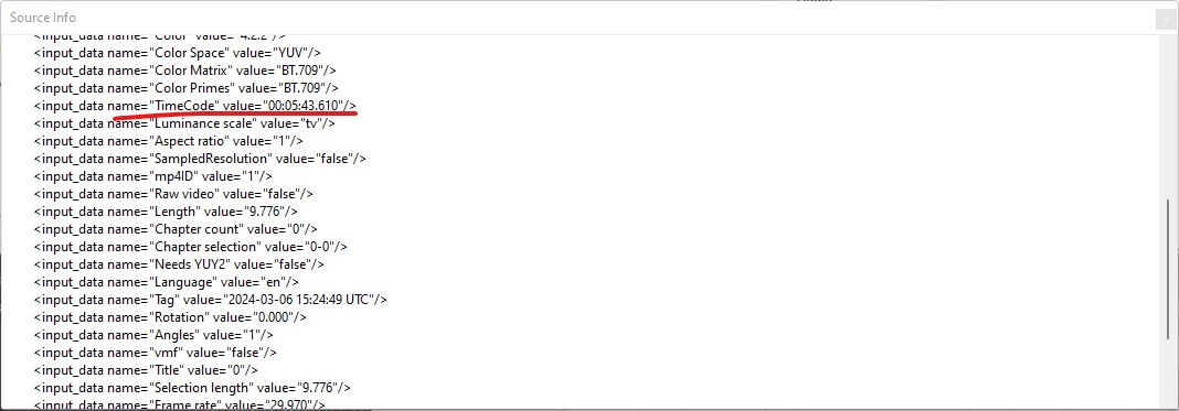

<input_data name="TimeCode" value="00:05:43.610"/>
The value Hybrid collects can also be seen, if you open the 'Show All Data' info in 'Base'-tab.
Which results in Hybrid using '-timecode 0:5:43.61'.
