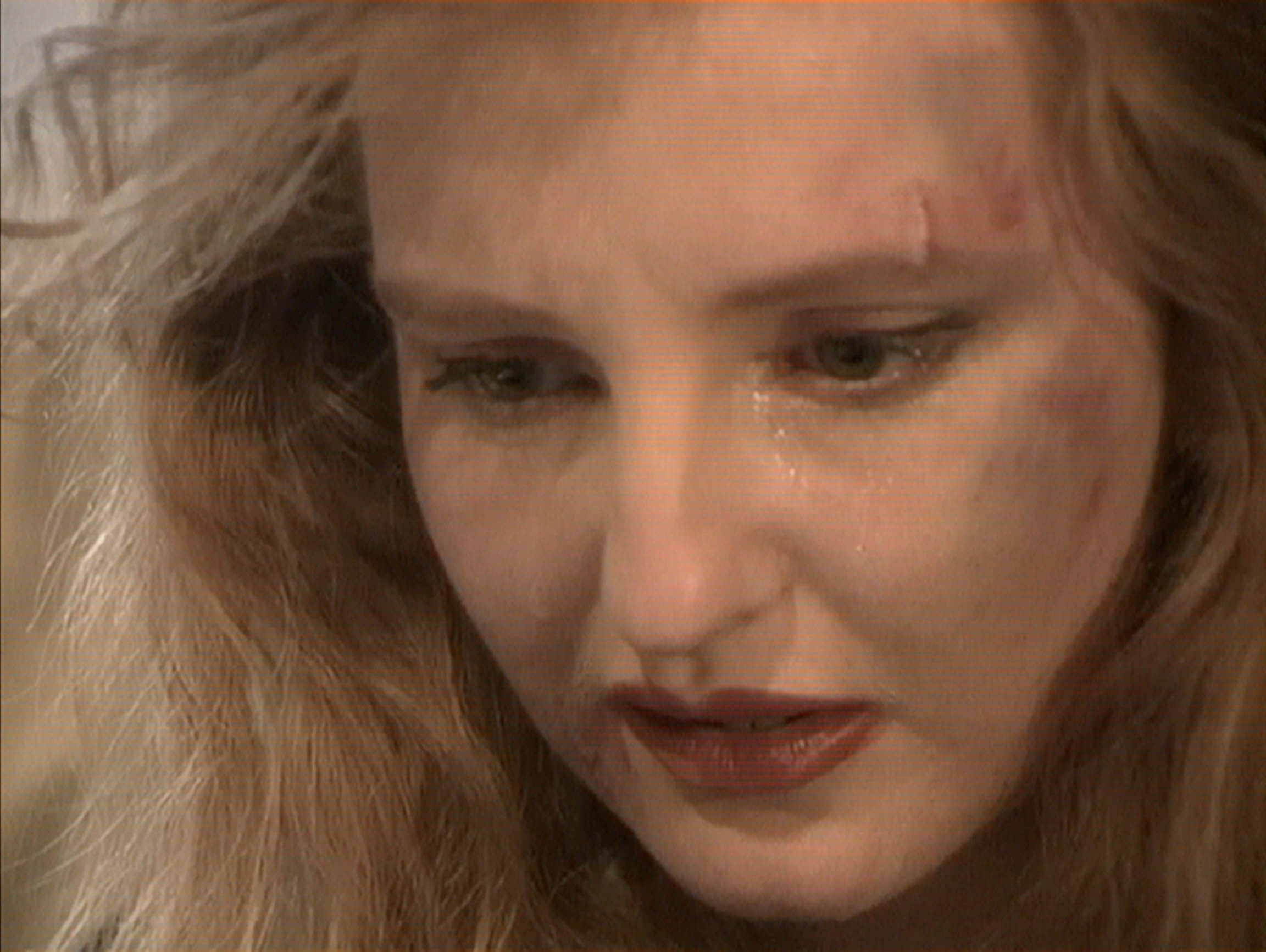

I seem to be getting this stange combing effect when upscaling to 29.97i - any suggestions?
From an image, I can't say where this comes from, whether these lines are static or moving,....
Just from the image I would say this is caused by some interference during the captue and already in the source.
So either you fix the capture process or try to filter this way. (would need a sample for suggestions)

When treating it as 'progressive' one clearly sees the lines.
If you treat it as interlaced and throw away half of the frames, you get one b&w and one colored frame.
This is confirmed if you separate the fields, you see that one field has color the other not.
So my guess it's either the source itself or some compatibility with the DV codec used for this.

Side question: if you overwrite the scan type to progressive and look at a scene with horizontal motion in it, do you see combing artifacts. By looking at the sample you shared (with basically no motion) I can't tell whether the source really is interlaced. Smile

It's definitely interlaced, bottom field first. I managed to re-export it to ProRes on an ancient Mac with the correct codec, it seems to look much better already, and is currently upscaling in Hybrid.
