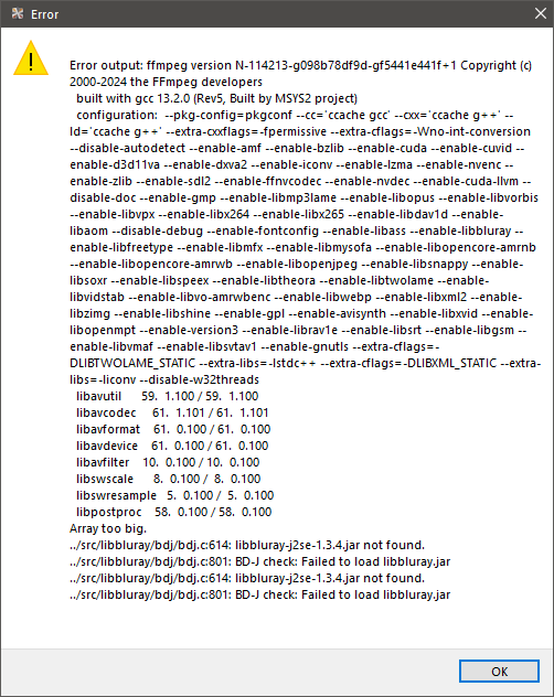

I am getting an 'array too big' error dialog when loading bluray content on multiple discs that have worked in past versions (last was 2024.03.10.1). This is with a default config (no custom profile loaded).
pic and debug log attached.

Okay, first time seeing this.
From the looks of it the Blu-ray seems to be authored in a way that libbluray can't handle the output.
Hybrid calls:
"C:\Program Files\Hybrid\64bit\ffmpeg.exe" -i "bluray:G:\rips\1080p\THE_STAND"
a. Do you see more infos when you call this in a Windows Command Prompt?
b. Does is work in Hybrid if you disable "Config->Input->Pre-select .mpls with ffmpeg" ?
c. How many files are there in the "G:\rips\1080p\THE_STAND\PLAYLIST"-folder? Assuming there are not too many, can you load them one at a time in Hybrid?
Ps.: as a workaround you could first remux the blu-ray with mkvtoolnix or makemkv.

a. I get:
C:\Users\Sub-Zero>"C:\Program Files\Hybrid\64bit\ffmpeg.exe" -i "bluray:G:\rips\1080p\THE_STAND
ffmpeg version N-114213-g098b78df9d-gf5441e441f+1 Copyright (c) 2000-2024 the FFmpeg developers
built with gcc 13.2.0 (Rev5, Built by MSYS2 project)
configuration: --pkg-config=pkgconf --cc='ccache gcc' --cxx='ccache g++' --ld='ccache g++' --extra-cxxflags=-fpermissive --extra-cflags=-Wno-int-conversion --disable-autodetect --enable-amf --enable-bzlib --enable-cuda --enable-cuvid --enable-d3d11va --enable-dxva2 --enable-iconv --enable-lzma --enable-nvenc --enable-zlib --enable-sdl2 --enable-ffnvcodec --enable-nvdec --enable-cuda-llvm --disable-doc --enable-gmp --enable-libmp3lame --enable-libopus --enable-libvorbis --enable-libvpx --enable-libx264 --enable-libx265 --enable-libdav1d --enable-libaom --disable-debug --enable-fontconfig --enable-libass --enable-libbluray --enable-libfreetype --enable-libmfx --enable-libmysofa --enable-libopencore-amrnb --enable-libopencore-amrwb --enable-libopenjpeg --enable-libsnappy --enable-libsoxr --enable-libspeex --enable-libtheora --enable-libtwolame --enable-libvidstab --enable-libvo-amrwbenc --enable-libwebp --enable-libxml2 --enable-libzimg --enable-libshine --enable-gpl --enable-avisynth --enable-libxvid --enable-libopenmpt --enable-version3 --enable-librav1e --enable-libsrt --enable-libgsm --enable-libvmaf --enable-libsvtav1 --enable-gnutls --extra-cflags=-DLIBTWOLAME_STATIC --extra-libs=-lstdc++ --extra-cflags=-DLIBXML_STATIC --extra-libs=-liconv --disable-w32threads
libavutil 59. 1.100 / 59. 1.100
libavcodec 61. 1.101 / 61. 1.101
libavformat 61. 0.100 / 61. 0.100
libavdevice 61. 0.100 / 61. 0.100
libavfilter 10. 0.100 / 10. 0.100
libswscale 8. 0.100 / 8. 0.100
libswresample 5. 0.100 / 5. 0.100
libpostproc 58. 0.100 / 58. 0.100
Array too big.
../src/libbluray/bdj/bdj.c:614: libbluray-j2se-1.3.4.jar not found.
../src/libbluray/bdj/bdj.c:801: BD-J check: Failed to load libbluray.jar
C:\Users\Sub-Zero>
b. disabling that does get me past the error, but then the video encoding immediately crashes. Also, using the crop analysis tool results in a 'crop crashed!' error dialog. Sometimes hybrid crashes after that, sometimes not.
c. the stand has 17 files in PLAYLIST. T2 has 57. I do have to disable the ignore playlist limits in input for the feature playlists to show up in T2.
yes, I know, but some of these blurays have multiple titles that need the playlist files analyzed in order to play back all the clips in the right order (eg Terminator 2 theatrical/directors edition)
