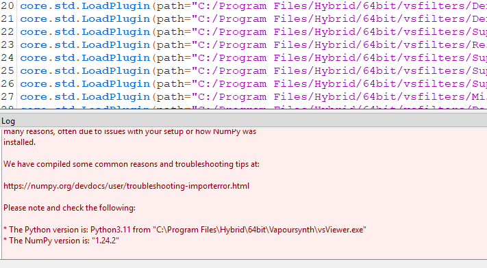

selecting it and selecting the "preview" button on bottom right is doing this on my system: (latest hybrid version)

not knowing the full script the error message doesn't help
For a quick test,
I rename
"Hybrid\64bit\Vapoursynth\Lib\site-packages\vsbasicvsrpp\models\basicvsr_plusplus_denoise-28f6920c.pth"
to
"Hybrid\64bit\Vapoursynth\Lib\site-packages\vsbasicvsrpp\models\_basicvsr_plusplus_denoise-28f6920c.pth"
and replaced "Hybrid\64bit\Vapoursynth\Lib\site-packages\vsbasicvsrpp\models\basicvsr_plusplus_denoise-28f6920c.pth" with a renamed basicvsr_plusplus_2x_denoise:
![[Image: grafik.png]](https://i.ibb.co/sQ7tRjd/grafik.png)
-> does not seem like that model is compatible with vs-basicvpp like it is atm.
