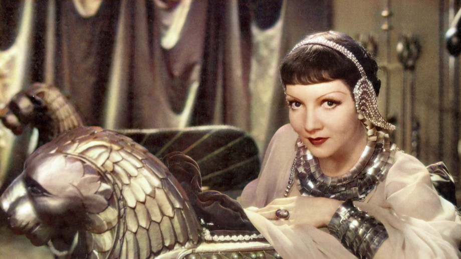

Here a frame obtained by using the vsDeoldify with the following code
![[Image: attachment.php?aid=2447]](https://forum.selur.net/attachment.php?aid=2447)
The colored frame is quite good, but the woman's hand is almost yellow.
Using the "Color Mapping" feature it is possible to correct this defect.

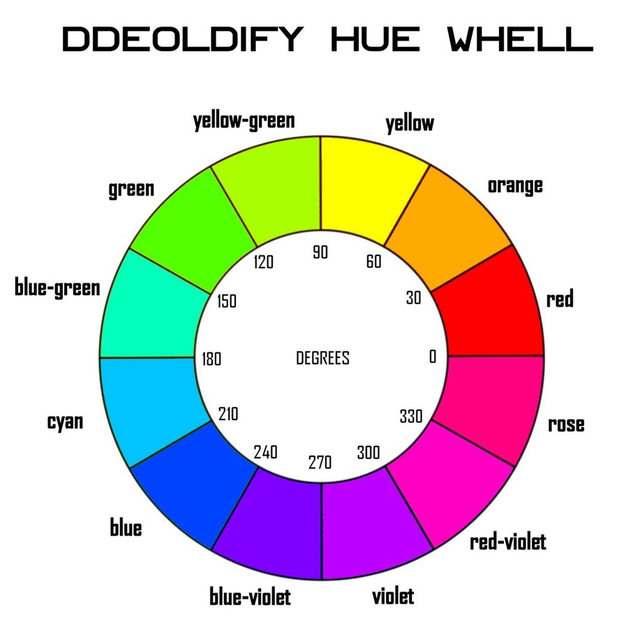

There are a lot of Painting programs that allows to see the HUE of a range of pixels, but the simpler approach is to use the following "DDEOLDIFY COLOR WHEEL"
![[Image: attachment.php?aid=2448]](https://forum.selur.net/attachment.php?aid=2448)
In the HSV color space the colors are specified in degrees from 0 to 360. In this case it is possible to see the the yellow range is between 60 and 90. But to be more conservative it is better to include also the orange, so that the chroma range that we want adjust is the following: "30:90".
Now that we have select the range, to change the colors we need to define the HUE SHIFT that need to be added to arrive to our preferred range of colors. We want to arrive in the range that in the HUE WHEEL is called "red-violet"/"rose". To arrive in this range we need to add about 250 degrees (250+30=280->"violet", 250+90=340->"rose").
clip = ddeoldify(clip=clip, ddtweak=True)
