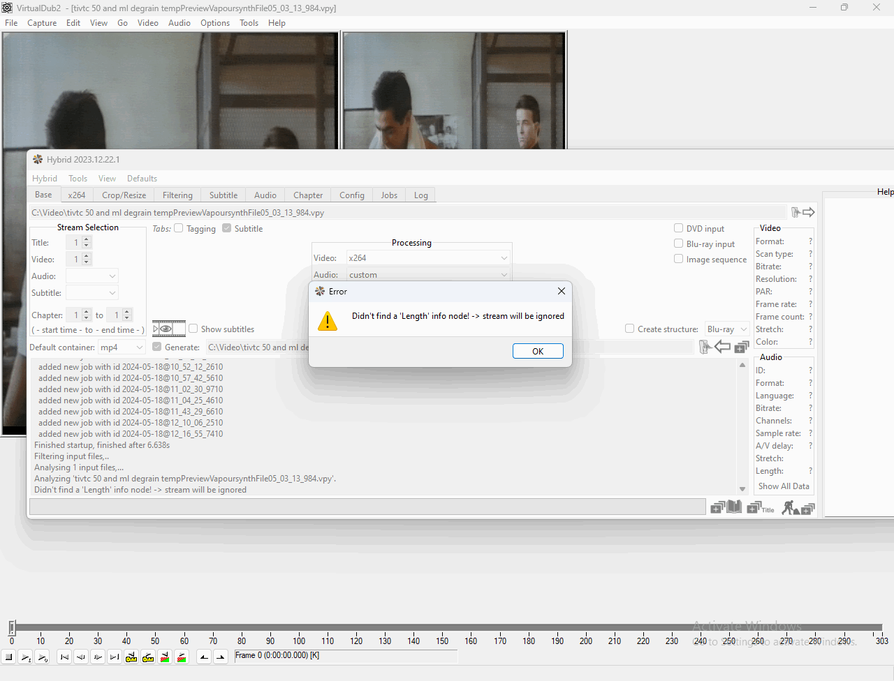

Did a quick test with, loading my version.py:
import vapoursynth as vs
core = vs.core
import site
clip = core.std.BlankClip()
clip = core.text.Text(clip, core.version())
audio = vs.core.std.BlankAudio()
clip = core.std.Trim(clip=clip, first=0, last=1)
clip.set_output(index=0)
audio.set_output(index=1)
Properly loads in Hybrid. (without audio, but with no length problem)
=> no clue why it's not working for you, my guess is that something is wrong with the script.
Problem also is that vspipe doesn't output any info that there are additional indexes.

Quote:if you remember, i installed python and vapour in addition to hybrid (to be able to load .vpy to vdub2), dunno if that could cause any weird interactions(?).
Yes, that can break everything.
Quote:i attached the dubug. kinda big, forgot to turn it off few months ago...
I deleted everything before '2024.05.19'.
2024.05.19 - 00:17:36_Windows 11 Version 23H2 (64bit)_2023.12.22.1 - level 9: tool(2): "C:\Program Files\Hybrid\64bit\Vapoursynth\vspipe.exe"
2024.05.19 - 00:17:36_Windows 11 Version 23H2 (64bit)_2023.12.22.1 - level 9: arguments(2):
--info
C:\Video\tivtc 50 and ml degrain tempPreviewVapoursynthFile05_03_13_984.vpy
2024.05.19 - 00:17:36_Windows 11 Version 23H2 (64bit)_2023.12.22.1 - level 9: Collected error output:
Script evaluation failed:
Python exception: No attribute with the name bs exists. Did you mistype a plugin namespace?
Traceback (most recent call last):
File "src\\cython\\vapoursynth.pyx", line 3124, in vapoursynth._vpy_evaluate
File "src\\cython\\vapoursynth.pyx", line 3125, in vapoursynth._vpy_evaluate
File "C:\Video\tivtc 50 and ml degrain tempPreviewVapoursynthFile05_03_13_984.vpy", line 28, in <module>
audio = core.bs.AudioSource(source=r"C:/Video/netwr0k video cache/vhs_tdk_240_mamets theater_12sec killing telecide with laced subs.avi")
File "src\\cython\\vapoursynth.pyx", line 2639, in vapoursynth._CoreProxy.__getattr__
File "src\\cython\\vapoursynth.pyx", line 2494, in vapoursynth.Core.__getattr__
AttributeError: No attribute with the name bs exists. Did you mistype a plugin namespace?
You are using stuff that exists in your global installation, but does not in the portable installation.
That is why 'pspipe --info "Path to script"' fails and thus Hybrid can't analyse the file.

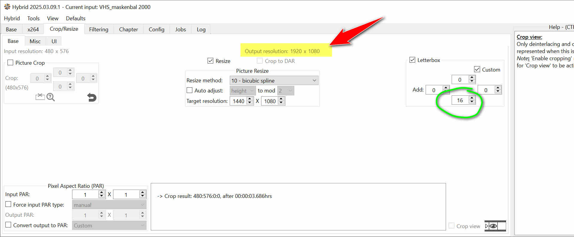

-would it be possible to add something like this
clip=core.std.Crop(clip=clip, left=0, right=0,top=0, bottom=12)
clip =core.std.AddBorders(clip=clip, left=0,right=0,top=0,bottom=12, color = [0, 128, 128])
to hybrid's "frame" options (vapoursynth filters), as all other filters on that tab don't seem to be able to just cover vhs headswitching noise on the bottom of the frame with black borders.....offcourse adding black borders on all four sides would be a plus....
(if it's not too much of a hassle to add it)
thanks

and then i wanted to upscale too:
(cropping is not turned on in this screenshot, but it was in previous attempt)
you're doing the following:
you take 480x576 source and crop xx pixels from the bottom (if one selects cropping and inputs the number)
you then upscale to desired resolution, and in doing so you're skewing the aspect ratio of the video, because you didn't add black borders to fill it in untill it's 576 again
final step is adding 16 pixels so that final video is of 1440x1096 resolution!
Width : 1 440 pixels
Height : 1 096 pixels
Display aspect ratio : 4:3
Frame rate mode : Constant
Frame rate : 50.000 FPS
Color space : YUV
Chroma subsampling : 4:2:0
on top, hybrid writes output resolution is 1920x1080.
what did i expect and what would be the proper way:
-crop 16 pixels
-letterbox ie add 16 black lines on bottom
-upscale
Quote:If I just add it to the Vapoursynth filtering, users will not use it, since even the users who would use it won't since they don't know it's there.
but what exactly can they use in hybrid incase they want to add black borders on bottom and upscale?
also, why do you even say that when you already have simillar things in filters->frame->edge section?
if the fillborders filter from that section had "solid black" mode, that would be it.
