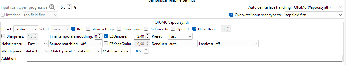

I'm trying to speed up my workjob using only the QTGMC (instead of QTGMC+TD2)
i'm mainly converting marriage VHS... i'm fascinated about the TD2 ability to "regenerate" Hairs (removing the squared pixels taken from camera CCD ) maintaining the same original resolution (720x576)
these are my actual deinterlacing settings (completely disabling TD2) ... any suggestion?

1st thing that comes to mind: Enabling 'Pad mod16' and 'OpenCL' might speedUp QTGMC a bit.

one suggestion, no clue about speed:
https://imgsli.com/MjcwOTU3
script: https://pastebin.com/SHXyJtgC
