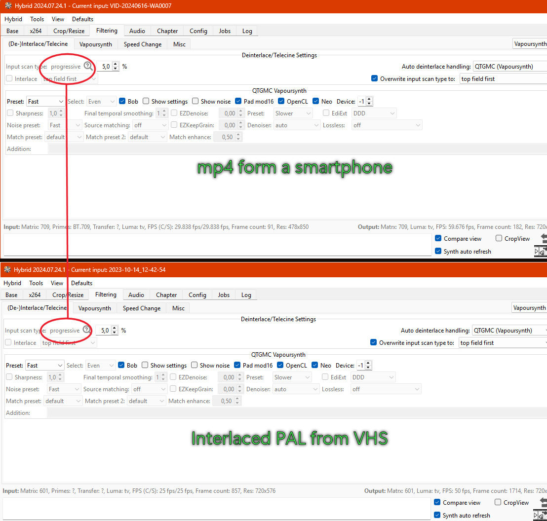

https://i.imgur.com/qmw3pXN.png
As shown above, there's no way to NOT select QTGMC or other deinterlacers... even if the project does not need one.

Posts: 157
Threads: 37
Joined: May 2023
i think that the issue is that users see "Progressive" greyed out... maybe better to remove the "progressive" text from the gui (if the source is an interlaced one) ... or clearly write "interlaced" ... .. or a text saying : video will be not deinterlaced
just to reassure users that no kind of "deinterlacing" is being done
also now i'm concerned about this:
i need to remove the "OVERWRITE SCAN" flag if i'm processing a progressive clip? (i set this enabled by defualt because i'm working on interlaced PAL... but how i can be sure that hybrid is not doing a deinterlacing job if this flag is set?)
looking at the ineterface seems that i need to remove the flag on modern videos... but removing it i have an "abort" processing the clip...
(this is a debug log without the OVERWRITE flag) :
http://www.wcn.it/debug.txt
http://www.wcn.it/abort.mp4

Selur, with this file: ( a progressive from a smartphone )
http://www.wcn.it/test.mp4
the rendering is aborting and i need to force some sort of deinterlacing to have a rendering.
using latest Experimental
Posts: 13.296
Threads: 73
Without a debug output, I have no clue what you are doing,...
Instead of forcing some deinterlacing, you could enable "Filtering->Vapoursynth->Misc->Script->Always use Vapoursynth" this should force Vapoursynth handling.
There also seems some issue with the time codes, which causes a crash during muxing.
(more or less time codes than frames,...) Enabling Config->Input->Decoding->CFR seems to help (this way Hybrid will not try to remux the time codes).
