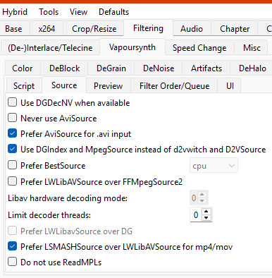

Quote: I couldn't find the place to change the decoder, could you point me to it?
The settings under Filtering->Vapoursynth->Misc->Source, determine the source filter.
You can check the Vapoursynth Script View to see which source filter / decoder is used.

on 3d attemp i removed "prefer bestsource" and again the audio displacement
now i'm rendering using MKV container, disabling "prefer bestsource" (waiting for the end)
