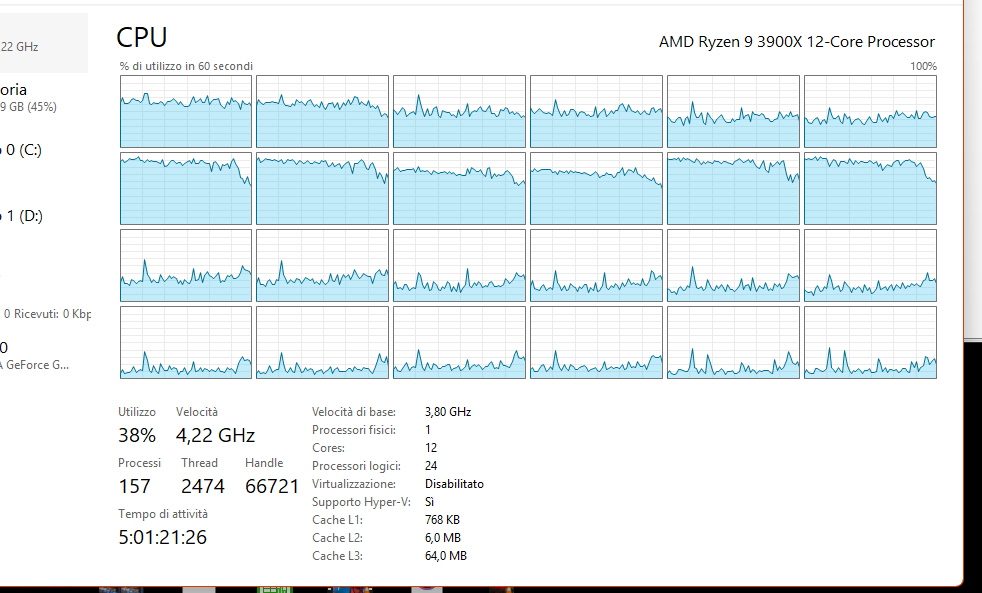

this need a lot.. because is used only 40% of the cpu... no idea why (usually i can use 85% )

Quote: this need a lot.. because is used only 40% of the cpu... no idea why (usually i can use 85% )
no clue either only thing that really changed was the preference of BestSource,...
