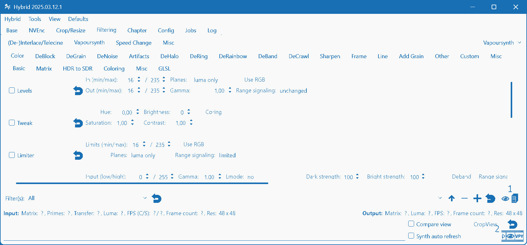

Sorry to bug you again Selur.
Where abouts do I find the script generated, so I can open it in VS Viewer? I'm assuming in a temporary folder, but haven't been able to find it.
Regards
Mike Mc.
1 => Script View, shows the script
2 => Preview Shows the Script Preview
see: attached image
While the script exists it's in the temp folder that is specified under Config->Path.
If the Preview is open, you can also open vsViewer through the tools menu entry (top of Hybrid) to open it in a separate vsViewer instance.
