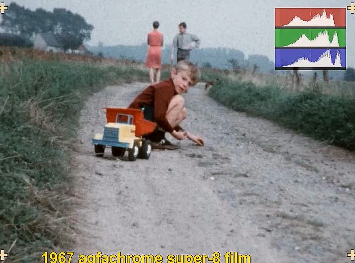

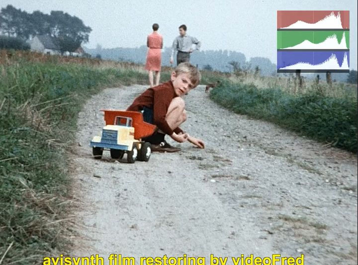

In the case there is interest in replicating the script I uploaded to archive.org the clip: film-restoring-1967-2-videofred
I tried to use the avs scripts provided by the author, more precisely this one: 01_C_Film_Restoring_Blending_Cleaning_Only.avs
I was able to obtain the following picture
 [Image: attachment.php?aid=3077]
while in the clip provided on YouTube the resolution/quality is better
[Image: attachment.php?aid=3078]
So it seems the restored clip was obtained using different settings.

#48
I didn't see a link to the source.
What is your source?
Are you using the left side of the youtube clip as source? If you do, I would not be surprised that you can't reproduce the effect.

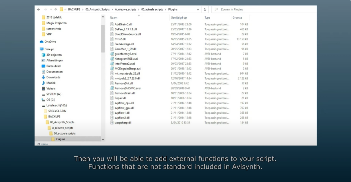

Also, I've attached a screenshot (from one of Fred’s videos) showing the plugins used in his Avisynth setup for reference.

#50
(12.04.2025, 12:43)Selur Wrote: I didn't see a link to the source.
The only source is the clip on YouTube, and yes, I'm using the left side of the clip.
