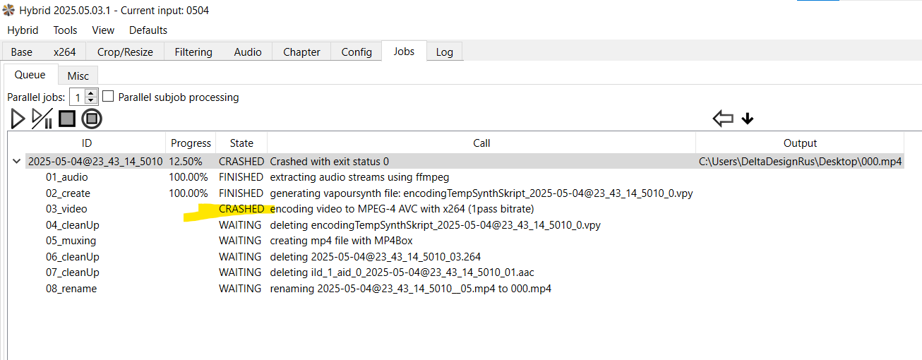

Hello,
When using the Vapoursynth deinterlacer MFDIN with the TRT=True option, Hybrid crashes already at the vspipe stage without outputting a single frame, and the next line in the log shows the encoder error:
x264 [error]: could not open input file `-`
If you disable TRT mode in the Hybrid GUI (TRT=False) or choose any other deinterlacer (e.g., QTGMC), everything works normally. Regardless of whether TRT is enabled or not, the preview always functions correctly but operates very slowly, at approximately 4–5 FPS.
Could the issue be related to launching Torch-TensorRT within MFDIN? Is it possible that the required versions of TensorRT or torch-tensorrt are missing, or that vspipe crashes due to internal plugin errors?
In the archive, I enclose a video clip demonstrating the issue, along with HybridDebugOutput.txt and Report.txt
Archive
I am using an RTX 5080 GPU with driver version 576.28
Hybrid_dev_2025.05.03-203037

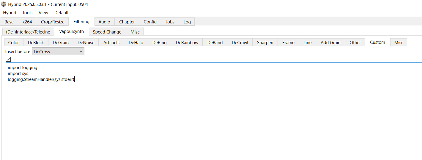

Does adding:
import logging import sys logging.StreamHandler(sys.stderr)
in a custom section, fix the problem?
No
