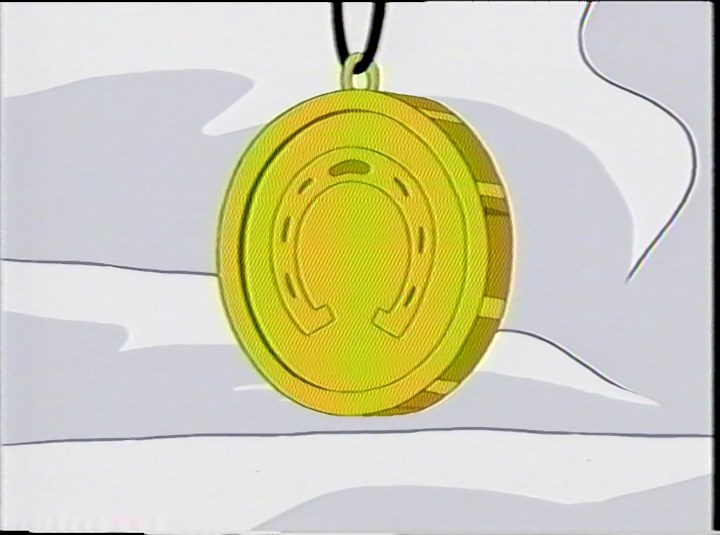

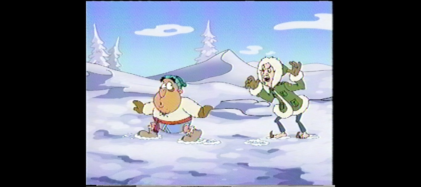

Hello! My Hybrid version is 2025.03.09.1 running on Windows 10. I am working with a digitized VHS tape from 2002, which is an animated series from the same year. This tape was digitized as interlaced video; all media info will be placed below. As a perfectionist, I digitized it in Hybrid, using VapourSynth and QTGMC Placebo mode. Please see the attached screenshots that were taken from my completed deinterlaced video. I don't like the final result because, even after deinterlacing in Placebo mode, you can see these horrible diagonal stripes everywhere (faces of the characters, snow, sky, etc.). Please tell me how to get rid of them using Hybrid? What settings do I need for it? I asked ChatGPT this question, and it recommended this:

Here is media info for my original interlaced video: Format: ProRes 422 HQ in a QuickTime MOV container • Resolution: 720x486 pixels • Aspect Ratio: 4:3 • Frame Rate: Listed as 59.940 FPS (100160000) • Scan Type: Interlaced • Scan Order: Top Field First • Bit Rate: 127 Mb/s • Bits/(Pixel*Frame): 6.053 • Duration: 23 minutes 40 seconds (1420 seconds) • File Size: 21.5 GiB • Color Space: YUV 4:2:2, BT.601 NTSC
Those lines are not caused by the deinterlacing.
Would need a link to a small sample to look at to give any suggestions.
No problem. Please tell me, do you want to get a sample of the original interlaced video, or a deinterlaced video? This problem with diagonal stripes can be seen on both.
Of the original please
I have uploaded a 15-second sample of the original interlaced video. Please take a look:
https://mega.nz/file/zMVGibSA#EtTyNJ3fad...loaRSe-ARU
Downloading the file, will report back once the download is finished, and I had a look at it and can suggest something. Smile
What graphic card are you using?
When I look at the sample and overwrite the scan type to progressive, there are no combing artifacts.
(there is a lot of aliasing)
=> that file is not interlaced
Intel HD Graphics 5500
Okay, so only conventional and not machine learning based filtering is needed. Smile
Please tell me how to get rid of these diagonal stripes using my current Hybrid version 2025.03.09? What settings do I need to apply?
