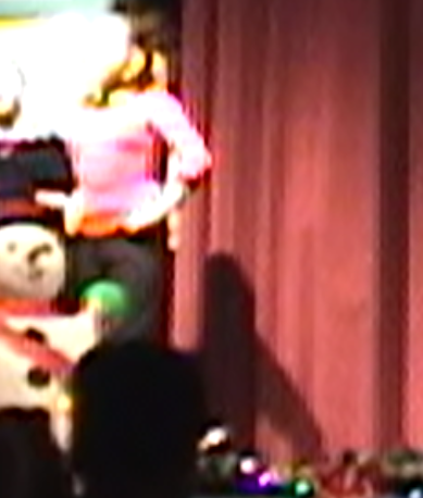

I have tripod shot dv avi footage with vertical banding (seemingly from chroma conversion issues with DV NTSC). I have all other settings for vapoursynth deinterlacing, denoise, and sharpening set.

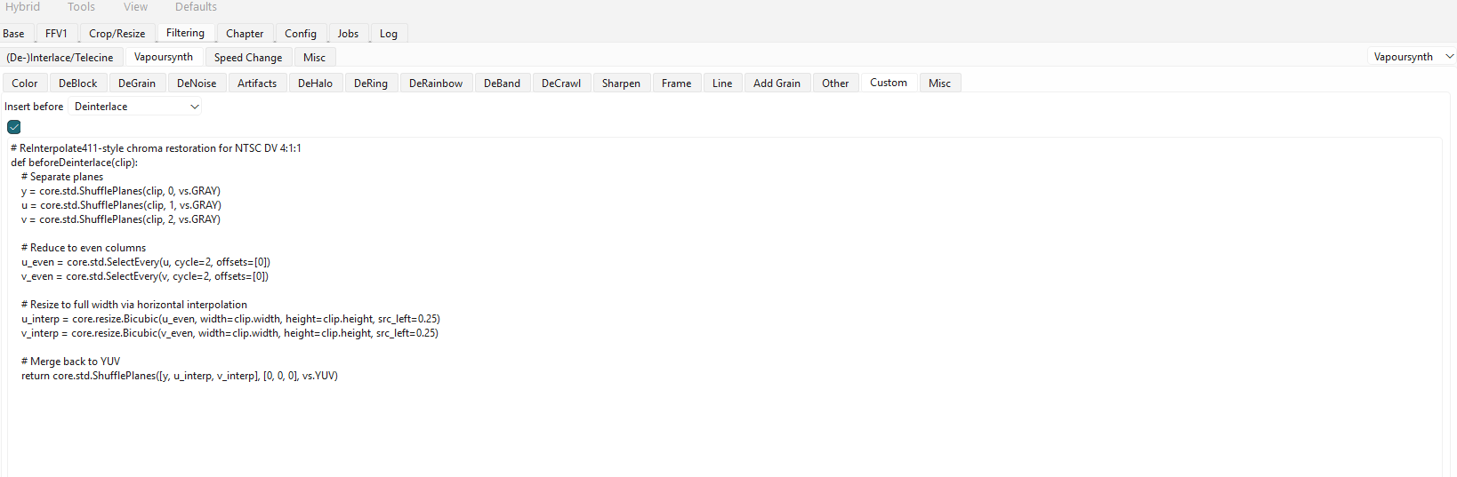

I inserted in the custom tab and inserted before deinterlace.
A.I. is saying the script hybrid generates has errors so I would appreciate help inserting the script properly (or confirming).

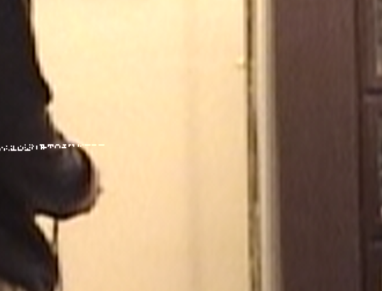

I attached a zoomed snip of the artifact I'm trying to resolve. It's a 29.97 bff ntsc conversion to an output from hybrid (QTGMC, denoise, sharpen). Irony for me is that I think these only seem to show in static footage (like tripod). Maybe indoor lighting plays a part.
Care to elaborate? Without you showing the complete code Hybrid uses, I guess your code generator messed up.
Looking at your code:
(I assume this should do some strange 4:1:1 to 4:4:4 upsampling.)
def beforeDeinterlace(clip): # Separate planes; Personally I would use https://www.vapoursynth.com/doc/functions/video/splitplanes.html here y = core.std.ShufflePlanes(clip, 0, vs.GRAY) u = core.std.ShufflePlanes(clip, 1, vs.GRAY) v = core.std.ShufflePlanes(clip, 2, vs.GRAY) # Reduce to even columns; No clue why this is used (https://www.vapoursynth.com/doc/functions/video/selectevery.html). It does not make sense to me. I assume the intention was to do something like a SeparateFields ? u_even = core.std.SelectEvery(u, cycle=2, offsets=[0]) v_even = core.std.SelectEvery(v, cycle=2, offsets=[0]) # Resize to full width via horizontal interpolation; That seems fine. https://www.vapoursynth.com/doc/functions/video/resize.html u_interp = core.resize.Bicubic(u_even, width=clip.width, height=clip.height, src_left=0.25) v_interp = core.resize.Bicubic(v_even, width=clip.width, height=clip.height, src_left=0.25) # Merge back to YUV; That seems fine return core.std.ShufflePlanes([y, u_interp, v_interp], [0, 0, 0], vs.YUV)
(Side note: Indentions are important in Python, so best use 'code'-tags when posting code.)
Assuming the syntax is correct, you need to let Hybrid know that after it the output is YUV444P8, by adding:
# colorformat YUV444P8
to the code, otherwise Hybrid wouldn't know that the color format changed to YUV444P8.
=> the whole code seems wrong to me
Ps.: Machine learning models are not that good atm. with code generation of anything slightly complex. Especially when not provided with all the necessary information. If you can share a sample of the unprocessed source you feed Hybrid and properly explain what you aim to do, I probably could add a suggestion on what to do.

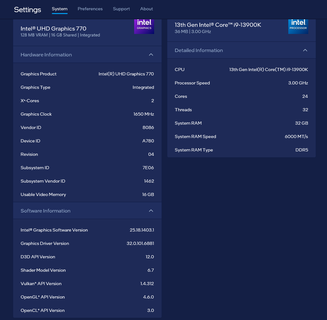

Also, does KNLMeansCL need a standalone GPU to function? At the moment I only have my i9 13900K CPU graphics and I recall errors when I initially tried using KNLMeansCL.

  • enabled and configured KNLMeans, which requires OpenCL drivers and should work with your onboard gpu

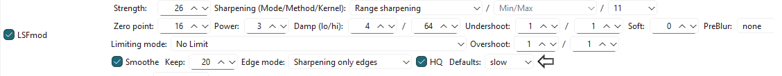

I can identify some presets but not all. Could I assume the first 4 you list are auto-handled in Hybrid once I set QTGMC presets? I note you select "fast". Would slower be beneficial to quality?
I can identify the last three presets. For KNLMeansCL d=0 - is this distance?
