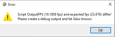

I'm running a bunch of old sd special features through Hybrid to losslessly de-interlace anything that needs deinterlacing before I encode in a different format, and one of the files is throwing this error:

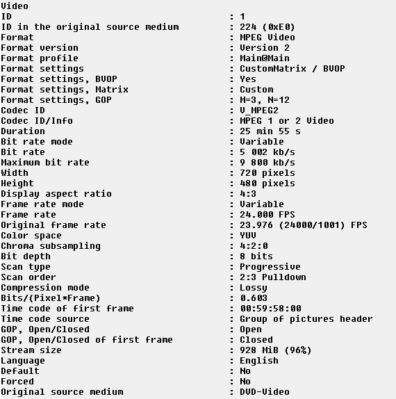

MediaInfo shows the framerate as 24.000 and the original framerate as 23.976.  If I check the box on the internals tab to "Prefer Original" framerate, then Hybrid fails to process the file (see debug).  If I uncheck the "Prefer Original" for framerate, the file does process successfully (and A/V sync looks good), but the framerate of the resulting file is 23.976, not 24.000.

The processing stops, since decoder call is lacking an input.
I guess the screenshot of the error message is the reason for this.
Juding by the screenshot for some reason, Hybrid assumes the vapoursynth script should create 23.976fps aas output, but the actually indicates to output 19.1808 fps.

The file is (soft) telecine and the source is reported as 24fps (by container) or 23.976fps (by the stream).
This combination is usually wrong.
Normally when a stream is (soft) telecine it's fps should be 29.97fps (or 30), thus that on playback ivtc gets applied and you end up with either 23.976fps (or 24fps)
This is something MakeMKV does, Hybrid does have workarounds for it, but by enabling 'Prefer Original->Frame rate' those will not take effect. Smile
If 'Prefer Original->Frame rate' isn't enabled, Hybrid will detect the source as 29.97fps and (soft) telecine. (And then like I wrote, get it down to 23.976fps through the source filter or ivtc)
This is the correct way to handle such a file to get the original progressive frames.
=> don't enable 'Prefer Original->Frame rate' on MakeMKV output in Hybrid. Smile
