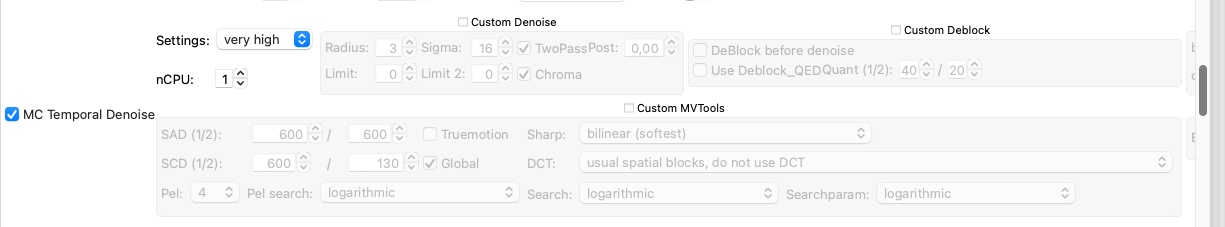

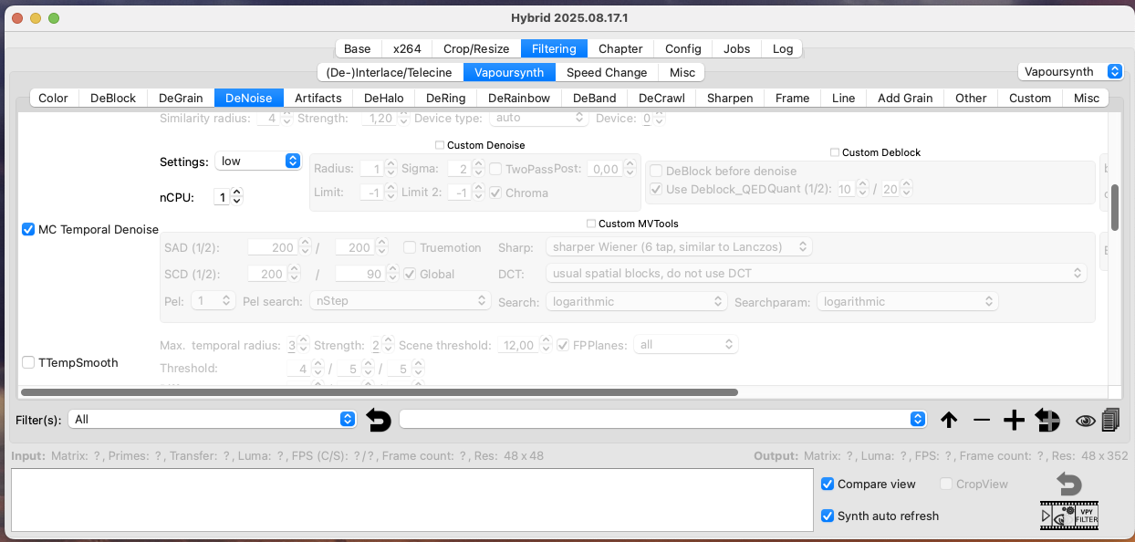

Where can I find this setting:
set 'Split Compare View' to 'Split YUV'.
I'll try this: MCTemporalDenoise(settings="very high") restricted to chroma:
But I don't see a "very high" setting?
see:
