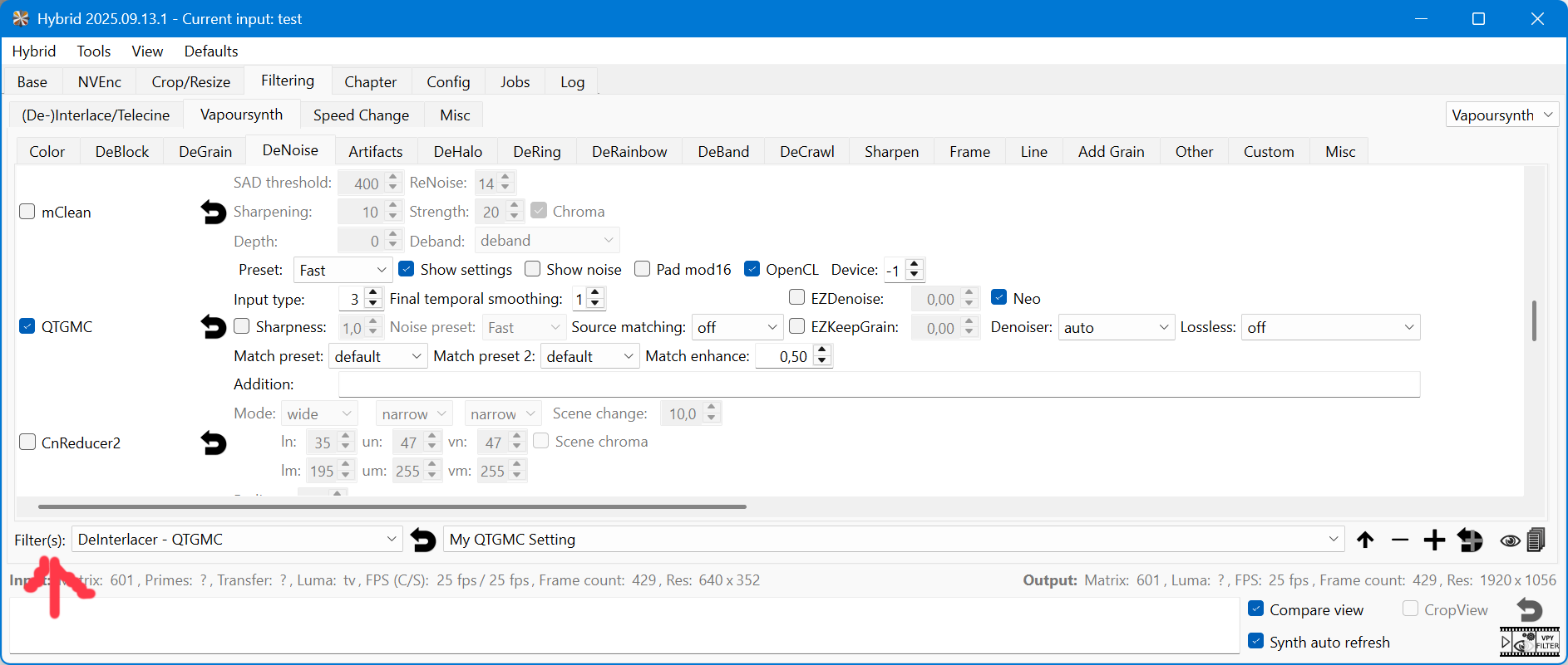

I am progressing and converting VHS and MiniDV cassettes to digital. The digitization was done a few years ago, so I am mainly converting Mpeg2 to ProRes currently. I used the previous version of Hybrid, which worked well for me. I need a few answers on the new version. I am currently using 2025.07.07 version 1
1.Advanced QTGMC Settings (nsize, nns)
AI advised to find the Advanced settings: Under "Filtering", to click on the sub-tab called "Deinterlacing",there was supposed to be a button near the QTGMC, where settings are labelled. "Show advanced settings", "Custom", or similar. I cannot find this button. This is for nsize and nns.
I also cannot decrease or change “Sharpness”. and also do not see the source video when I am starting to convert. Your advice re the visibility or location of nsize and nns would be welcome. A screenshot(s) is (are) actually better.
Another AI: Filtering tab>Deinterlacing sub-tab>Ensure QTGMC is selected> Look for button, but no luck!
There is a block that I can tick for “sharpness”, but is dead or needs to have other permissions ticked as well. Sharpness remains thus at 1 for now.
2. Preset File
We developed a preset file, that should be uploaded under configuration> Load preset. I cannot find that section.
A second AI said I should go to Hybrid’s Main Menu bar>In dropdown, select”Load preset”. I cannot find that either. Could you please help here as well?
As there are so many videos, I will take a type of “middle road approach” as I will obviously have much more to do.
Can you please help me with Advanced QTGMC Settings, sharpness and loading of a preset file (script)?

Sorry, but machine learning isn't that good at advising on stuff that isn't widely documented.
Quote:I used the previous version of Hybrid, which worked well for me. I need a few answers on the new version. I am currently using 2025.07.07 version 1
There are really not much changes do older versions,..

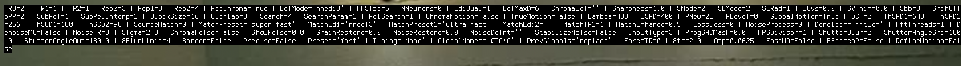

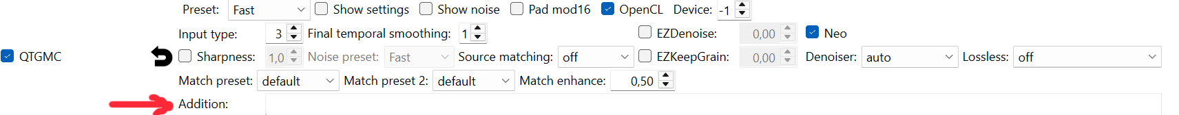

You can add, custom settings, that are not covered by the GUI, through the 'Addition' option. (this hasn't changed for ages)
If you want to see all possible options, enable 'Show Settings' and check the preview.
alternatively, you can see them in the source code of the script. Here's a list of the script documentation:
No clue, what 'preset' file you are reffering to, but Hybrid has multiple ways to save/load settings, read: [INFO] About profiles and saving settings,....
If you are reffering to some filter setting specifically for "Filtering->Vapoursynth->Denoise->QTGMC" one would use the options under the Vapoursynth Filters:
This will allow to load and save such configurations located under "<your 'Settings Path'>\profiles\scripts\Vapoursynth\DeInterlacer - QTGMC"
(You can check the location of your 'Settings Path' under Config->Paths.)
=> I strongly advice against trying to use some chatbot on advice on how to use Hybrid. Settings always should to be adjusted to the source and unless the tool you use can actually see and test what the changes it suggests really do, it can only produce wrong suggestions.
