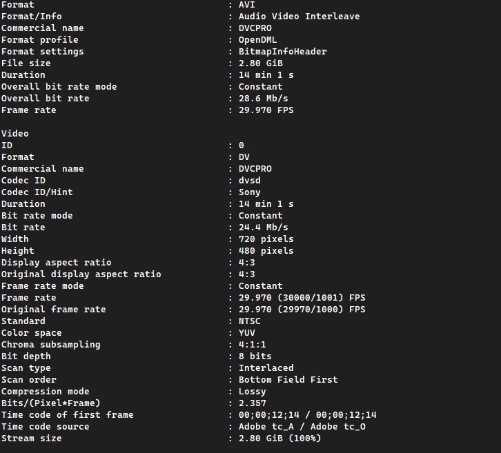

To be frank, I would have expected a loss of 12 seconds and 14ms not 5ms, since the short Mediainfo output (detailed output is preferable), states that the Time Code of the first frame is at "00;00;12;14" and I assume that translates to 12 seconds and 14ms.
So Hybrid will probably ignore it. (doesn't make any sense to add a delay to a video only stream)

Sorry about the log,  I now have learned how to create one (attached).
I turned Avisynth on,  same 13:56 result.  (image attached)

AviSource can't be used since there is no 64bit vfw handler for VIDC.dvsd on your system, only:
vidc.i420
  vidc.iyuv
  vidc.mrle
  vidc.msvc
  vidc.uyvy
  vidc.yuy2
  vidc.yvu9
  vidc.yvyu
=> Aside from manually adding frames in a custom section there is nothing you can do about this.
Hybrid does not, and will not support adding delays though time codes, especially not on video only files, where delay makes no sense.
Can't say whether any other tool supports such delays.
=> Hybrid is probably not the right tool for you / your files.
