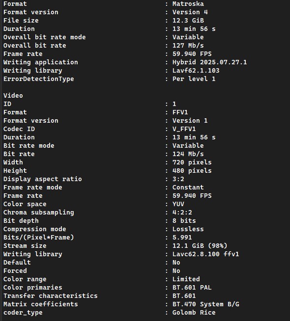

    I am deinterlacing a NTSC 720x480 DV AVI 29.97fps video with its 4:3 appropriate aspect ratio PAR into a 640x480 square pixel Bob 59.94fps .MKV.  Later I intend to upscale in Topaz Starlight Mini.
It seems to have done an OK job visually, but the resulting video is 5 seconds shorter than the original.
The 5 seconds seems to have been cut from the first 20 seconds of the video (not a gradual loss of time). The 1st 20 seconds of the original video is a kind of lead in black video. The scene first fades in at 0:21 in the original, but in the converted video, it fades in at 0:16. So obviously the 5 sceonds is somehow cut from the first part of the AVI video.

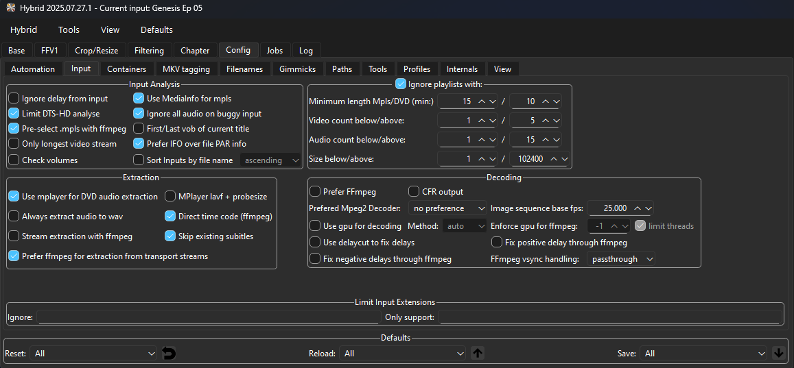

The original has no audio track, nor subtitle track. I've tried a few options in Hybrid. The Config > Input > Ffmpeg vsync handling: passthrough, cfr, vfr, those 3 produce a video which is 13:56 seconds long when it should be 14:01.  I also tried 'drop' which didn't work.

Sorry about the log,  I now have learned how to create one (attached).

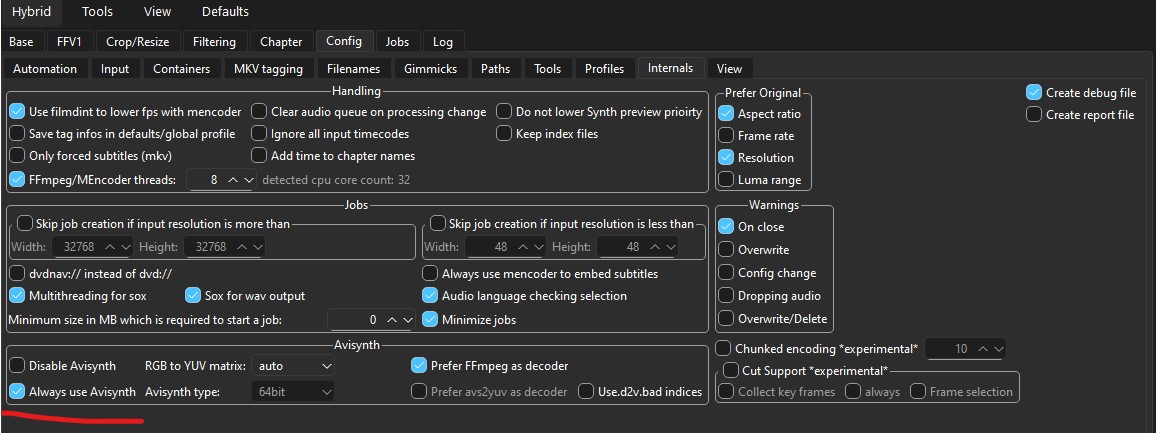

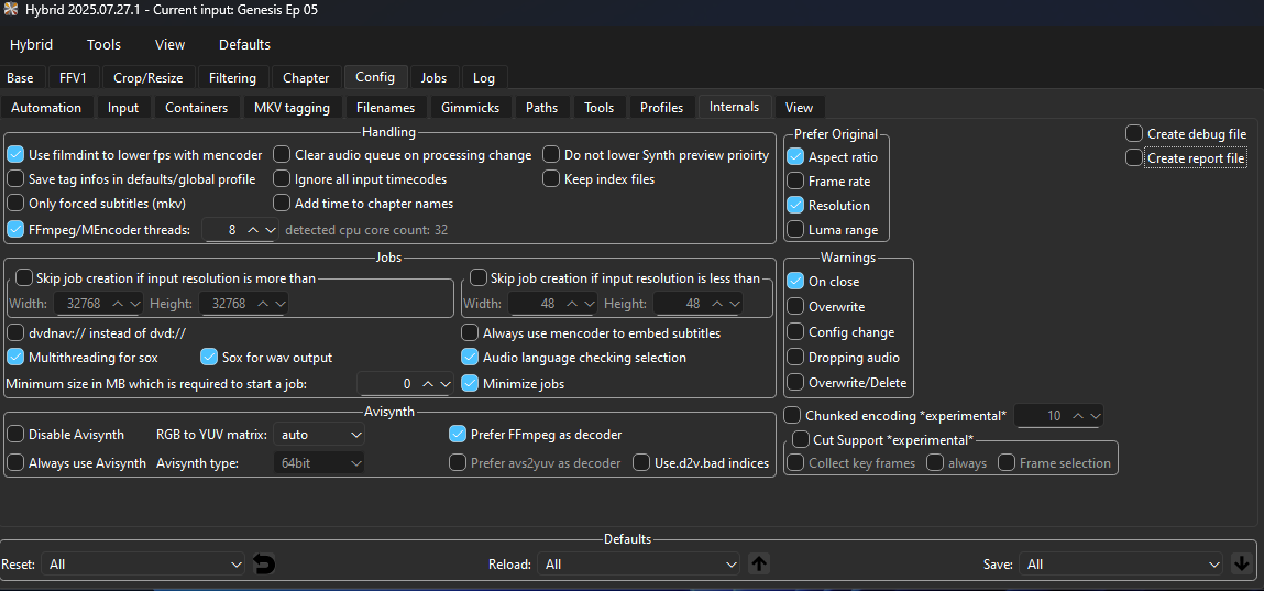

I turned Avisynth on,  same 13:56 result.  (image attached)

Config → Input:
Ignore delay from input: OFF
Fix positive/negative delays: OFF (both)
FFmpeg vsync handling: drop (also tested: cfr/passthrough/vfr/ → same 13:56 result, drop didn't work either)

AviSource can't be used since there is no 64bit vfw handler for VIDC.dvsd on your system, only:
vidc.i420 vidc.iyuv vidc.mrle vidc.msvc vidc.uyvy vidc.yuy2 vidc.yvu9 vidc.yvyu
=> Aside from manually adding frames in a custom section there is nothing you can do about this.

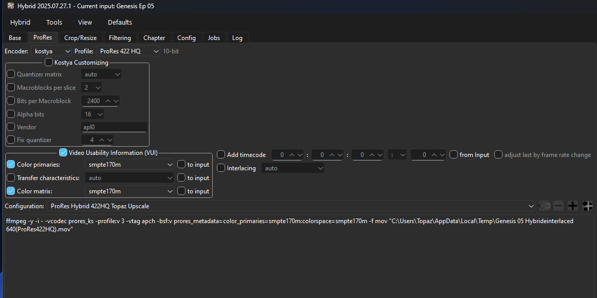

How do I ensure export from Hybrid is 59.94?   It shows 59.94 for .MKV, but now I switched to ProRes422HQ, its saying its 60fps.
I'm not 100% sure how to add custom flags, I'd like to add:
-r 60000/1001 -vsync cfr -video_track_timescale 60000
How do I do that?
You can't.
Quote: It shows 59.94 for .MKV, but now I switched to ProRes422HQ, its saying its 60fps.
mkv is a container, prores a video codec, those are different things.
No clue, what you are doing.
Using a random file using ProRes422HQ and a mov container, the encoding call looks like:
ffmpeg -y -noautorotate -nostdin -threads 8 -color_primaries bt470bg -color_trc smpte170m -colorspace bt470bg -color_range tv -i "/Users/selur/Desktop/test.avi" -map 0:0 -an -sn -vf fps=59.94 -color_primaries bt470bg -color_trc smpte170m -colorspace bt470bg -color_range tv -pix_fmt yuv422p10le -strict -1 -r 60000/1001 -vcodec prores_ks -profile:v 0 -vtag apco -metadata encoding_tool="Hybrid 2025.10.06.1" -aspect 640:352 -f mov "/Users/selur/Output/test_1_2025-10-13@20_29_04_8010_01.mov"
fps seems to be properly set.
How are you adding these flags:
-vf fps=59.94
-r 60000/1001
I tried Filtering > Speed Change > Scale Output frame rate: 59.94fps, but that didn't add the flags to the ffmpeg command line.
Strange, it did here,... using the latest dev version.
