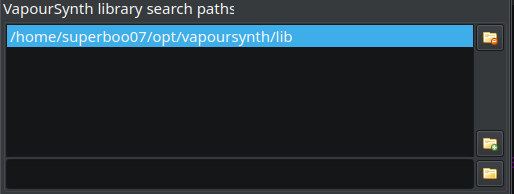

I switched to KDE Neon which is ubuntu and thus debian based. The actual official ubuntu vapoursynth install scripts work here without a hitch, but when opening the VS preview, I see this error. So far I've tried manually adding the vapoursynth library location to the vsedit library search setting thing, but I had no luck.
VapourSynth plugins manager: Failed to load vapoursynth library! Please set up the library search paths in settings. Failed to initialize VapourSynth environment! Failed to initialize VapourSynth environment! Failed to initialize VapourSynth environment! Failed to initialize VapourSynth environment! Failed to initialize VapourSynth environment! Failed to initialize VapourSynth environment! Failed to evaluate the script.

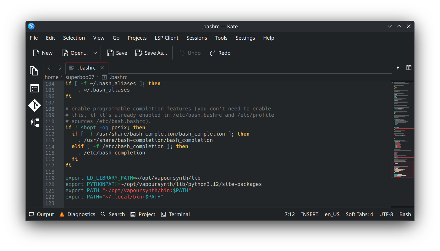

  • The https://github.com/Selur/hybrid-vapoursynth-addon scripts are meant to be used if you install Vapoursynth and the plugins through them. First building vapoursynth, then the plugins. If you install either from different sources do not use these scripts.
  • Quote:Failed to initialize VapourSynth environment!
    if you get this when using build-vapoursynth.sh, you forgot step 4 of https://github.com/Selur/hybrid-vapoursy.../README.md
