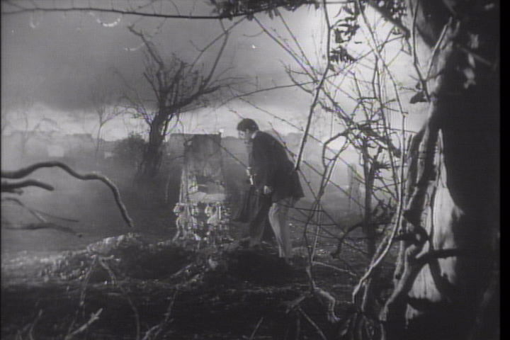

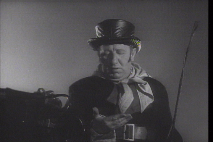

I recorded both sides of my LaserDisc copy of Bava’s Black Sunday with AmaRecTV in lossless using my IOData GV-USB2 capture device, which has an excellent comb filter. After concatenating the two .avi files with avidemux, I then performed an inverse telecine in Hybrid and the video looks so much better than the raw capture. Still, the source used for the transfer is struck from a dated master which you can see from the screen captures I’ve appended.

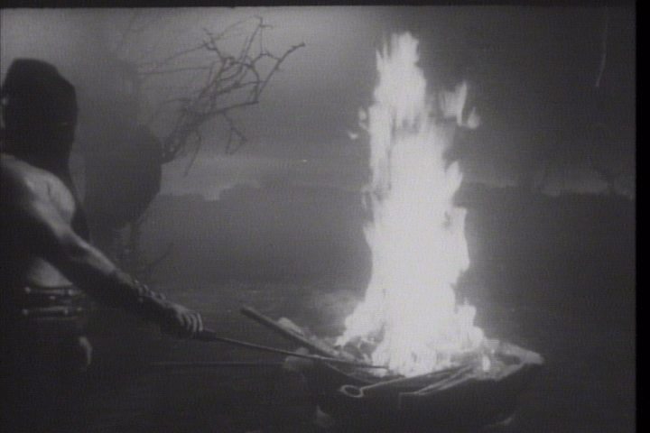

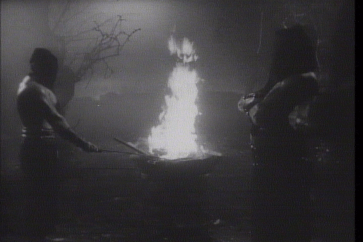

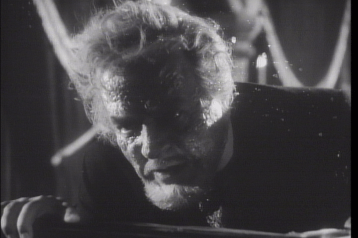

There is mild to moderate rainbowing throughout the presentation and I would love to use any of the DeRainbow filters in VapourSynth to eliminate the issue. You’ll see some of it on the left side of the man’s top hat in Screenshot #3, along the long rifle in #4, and along the ultra-thin branches in #6. I wonder which of the five filters would possibly work best?

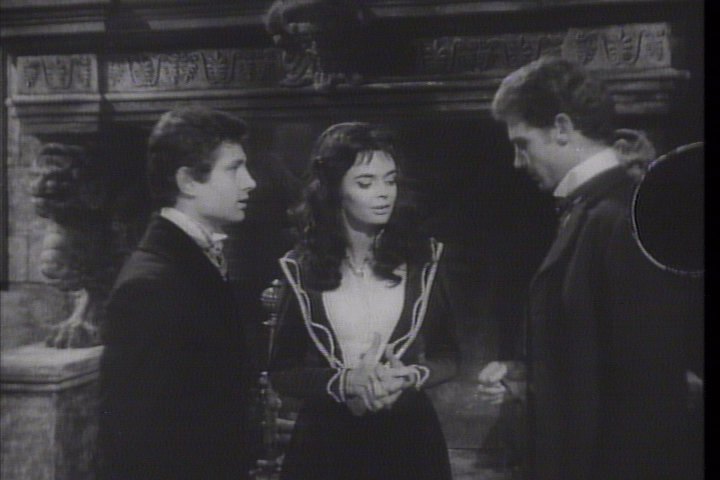

In Screenshot #s 1 and 2, there appear to be some hairs emanating from the film’s camera gate.

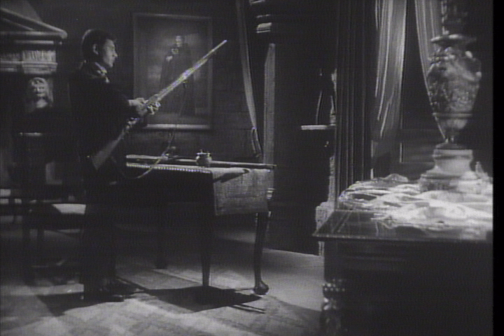

In addition, a cigarette burn pops up along the right side of the shot in #5 to signal a cue change in the reel. Of the three Artifacts filters, would Despot, KillerSpots, or SpotLess be effective in expunging it?

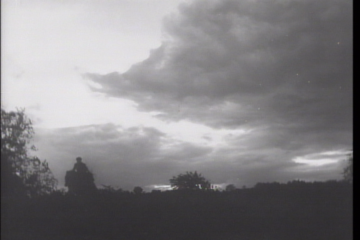

There are general age-related artifacts such as speckles, dirt, and other debris that are occasionally sprinkled throughout the image as you can see in frame grab #s 7 (amongst the clouds) and 8. Should I try mClean, RemoveDirt, or RemoveDirtMC? I don’t want to scrub away too much grain and detail to the extent that I’d deface the image so seeking filter(s) that can perform moderate cleanup.

Can't really suggest anything based on screenshots, since they lack the temporal component of the video.
Upload a sample of your video to something a fileHoster like GoogleDrive, MediaFire, or similar (not YouTube or such where file get reencoded) and share a link.
As a start, the default order of filters is fine, depending on the strength and nature of the noise&co filtering the fields before ivtc or deinterlacing can help.
You are probably looking for Filtering->Vapoursynth->Misc->Filter Order/Queue regarding changing the order of filters. Additionally, looking at the Vapoursynth Script View shows also the used filters and script generated.
Ps.: I usually try to avoid RemoveDirt(MC) and prefer SpotLess, Despot, MCTemporalDenoise or SMDegrain, but that all depend a lot on the state of the video,...

  • for the dirty, small glitches&co I would first try SMDegrain (increasing the SAD value, setting ContraSharp to 50 and increasing the temporal radius)
  • for scenes where this is not enough, SpotLess might be a good idea (only per scene not as a global setting, since it can be rather aggressive). (Filtering->Vapoursynth->Misc->UI, offers to enable some extended controls, which allow to restrict filters to frame ranges&co)
  • maybe also add additional sharpening, depending on personal preferences
