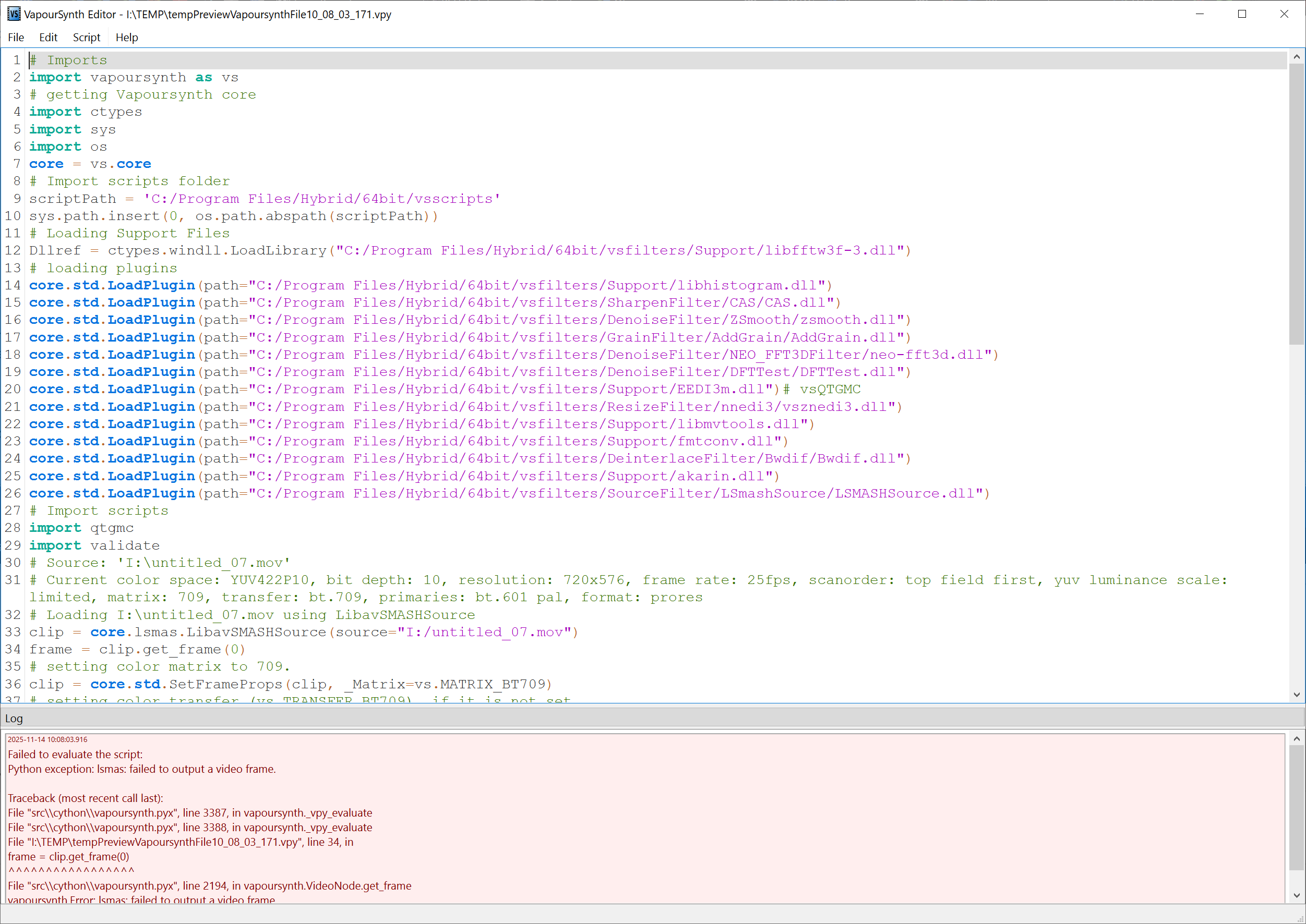

For some reason VapourSynth's viewer and subsequent encoding crashes with ProRes source from AJA's ControlRoom (Hybrid 2025.05.18.2)

AFK atm. did you try another source filter? I.e. BestSource?
Exclamation
This actually fixes the problem, but I don't quite understand why..
BestSource uses a newer libav library as source and that propably fixed some problem related to the format or container.
