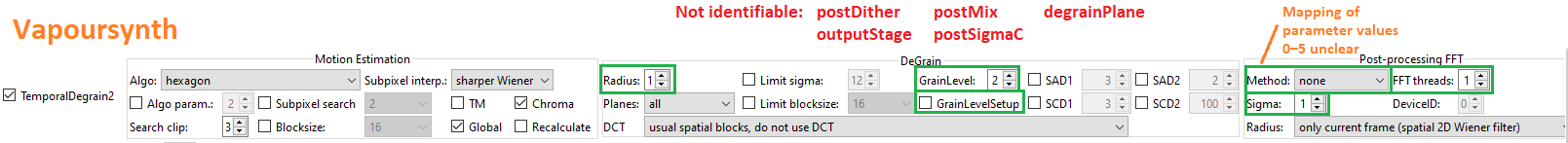

However, the parameter sets that are made available in the Hybrid GUI under (a) x264 > Filtering > Avisynth > Grain > TemporalDegrain 2 and (b) x264 > Filtering > Vapoursynth > DeGrain > TemporalDegrain2, are different from each other and do not correspond to those 11 parameters, as shown in these screenshots (green: parameter identified; red: parameter not identified).
I would need to access some of the parameters that are not included in this GUI. So here is my question: As a workaround, is it possible to specify the TemporalDegrain2 filter for Vapoursynth in Hybrid directly, i.e. by replacing the automatic call with in Hybrid with something like "TemporalDegrain2 (degrainTR=1, grainLevel=0, postFFT=1, postSigma=0, outputStage=1, postMix=25)"?
