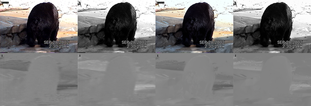

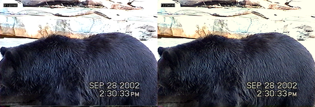

Looking at 077:

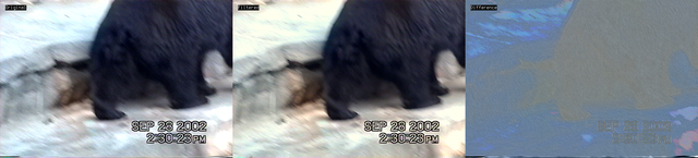

For general processing, I would: - overwrite the scan type to "top field first", so that Hybrid will automatically deinterlace the source

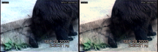

- enable 'Auto White' or 'Gray World'
![[Image: grafik.png]](https://i.ibb.co/v4LTMNrY/grafik.png)
- crop all black bars
- add a sharpener i.e. "CAS(strength=0.7)", idrectly after the crop (filter order needs to be adjusted for this)
![[Image: grafik.png]](https://i.ibb.co/0kbMFk7/grafik.png)
you maybe might want a lower the strength to 0.5
- add EdgeFixer "edgefixer.Continuity(clip, bottom=8, radius=3)" behind the crop, but before CAS (filter order needs to be adjusted for this)
![[Image: grafik.png]](https://i.ibb.co/gXJ36Z9/grafik.png)
maybe additionally setting top=4.
About denoising&co, this often comes down to personal preferences.

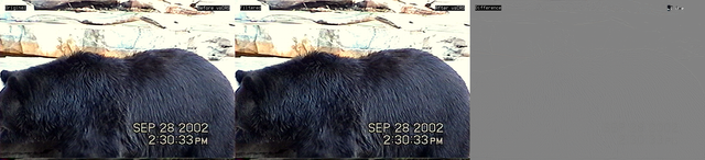

Personally, I don't think the source is that noisy, I would probably just use something like SMDegrain "smdegrain.SMDegrain(clip, tr=3, contrasharp=30, interlaced=False, opencl=True, device=-1)":
![[Image: grafik.png]](https://i.ibb.co/VcMHw3w6/grafik.png)
or one of the other Degrain filters.
Depending on what you are aiming to do, with the output of Hybrid, adding BasicVSR++ (applied on Chroma only; note: BasicVSR++ requires an NVIDIA gpu and the torch add-on)
![[Image: grafik.png]](https://i.ibb.co/RpgRfHLw/grafik.png)
You could also apply some denoising and restrict it to the darker areas (using a LimitMask)

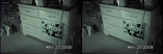

Took a quick look at 073.
Dark noise such as this will require some heavy denoising.
try something like:

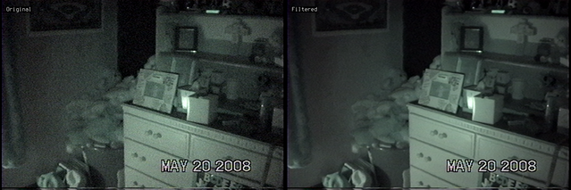

a. mClean (adjust values to your licking)
![[Image: grafik.png]](https://i.ibb.co/JjFd2f88/grafik.png)

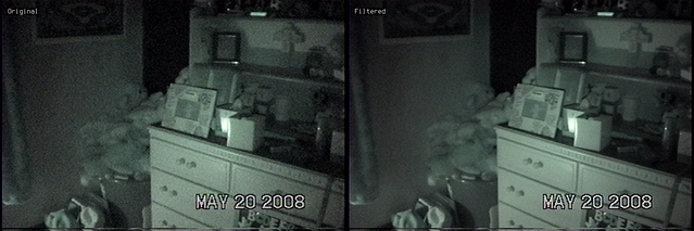

b. MC Temporal Denoise, with preset 'very high' (adjust values to your licking)
![[Image: grafik.png]](https://i.ibb.co/fGFHcByb/grafik.png)
c. SCUNet (mlrt) / SCUNet (require a fast gpu and the vs-mlrt or torch add-on)
![[Image: grafik.png]](https://i.ibb.co/1YFG6JG4/grafik.png)
other denoisers will not be strong enough, and the setting used for such content should probably not be applied to daylight content.
Ps.: If you want to use one filter chain for all, mClean is probably the best of those.

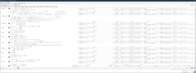

By enabling 'Filtering->Vapoursynth->Misc->UI-Show 'Apply only to'-controls' there's an 'ApplyOnlyTo'-Groupbox next to each filter, which lets you specify where the filter effect should be applied.
There are a quite a bit more controls available, then there are visible by default:

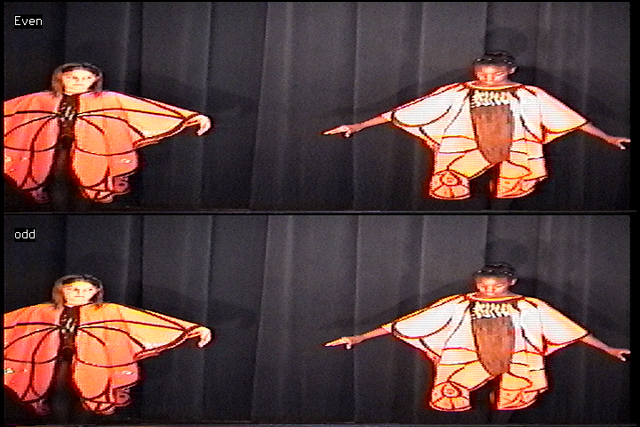

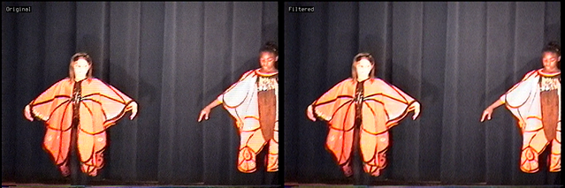

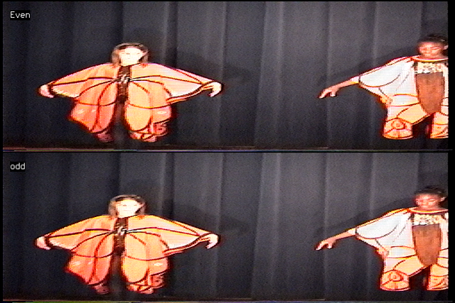

The 071 clip seems like it was not captured properly, like the content was interlaced and deinterlaced and reinterlaced and somehow this was messed up.
looking at the fields
![[Image: grafik.png]](https://i.ibb.co/V0khSB2f/grafik.png)
those lines should not be there,... or I image the natural look quite different than it is.
Posts: 13.364
Threads: 76
For 071, for start I would: - overwrite the scan type to "top field first", so that Hybrid will automatically deinterlace the source
- set "Misc->Script->Filter interlace handling" to "separate fields"
- Frame->AntiAliasing->Santiag and move it above the deinterlacing (filter order needs to be adjusted for this)
![[Image: grafik.png]](https://i.ibb.co/zW8DpJq7/grafik.png)
Problem is to get rid of those color lines one looses some sharpness
- adding a sharpener i.e. "CAS(strength=0.7)", before Santiag lessens this a bit (filter order needs to be adjusted for this)
- add SpotLess.SpotLess(clip, rec=True, pel=1, smoother="zsmooth")
from the look of it, the input should be PC not TV scaled, so you will need to do some color adjustment,..
