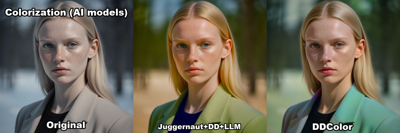

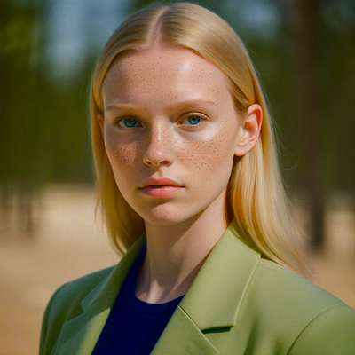

The two photos turned out very well. 😊
Even though the generated reference images contain some fictional/non-existent figures, CMNET2 seems to handle them surprisingly well during the actual colorization process and does not transfer those artifacts into the final video.
It seems that the solution may really be in finding the right prompt. Perhaps adding a negative prompt could help reduce these generated figures even further, or maybe a newer model in the future will handle this type of scene more accurately.

Lightning models do not support negative prompt. Try to experiment with different prompts till you get the optimal result for you.

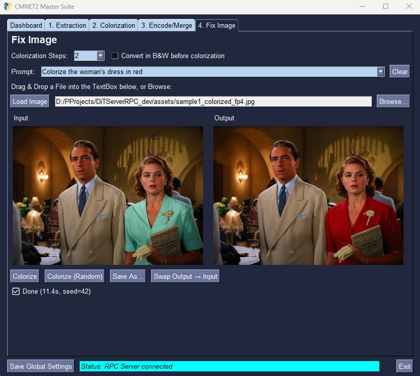

I recently release an update to the GUI of DiTServerRPC
I added a new tab called "Fix Image"
[Image: attachment.php?aid=3639]
I added this tab to simplify the adjustment of frames already colorized. For example in the image above I asked to Qwen to change the color of woman's dress to read.
Using the prompt it is possible to apply any type of color adjustment using the powerful AI of Qwen. It is also possible to apply the changes recursively by using the button "Swap output".
Using this button the image previously colorized is set as input for the next fix/colorization.
I hope this addition can be helpful for users who want to try coloring movies with cinema-grade quality.
