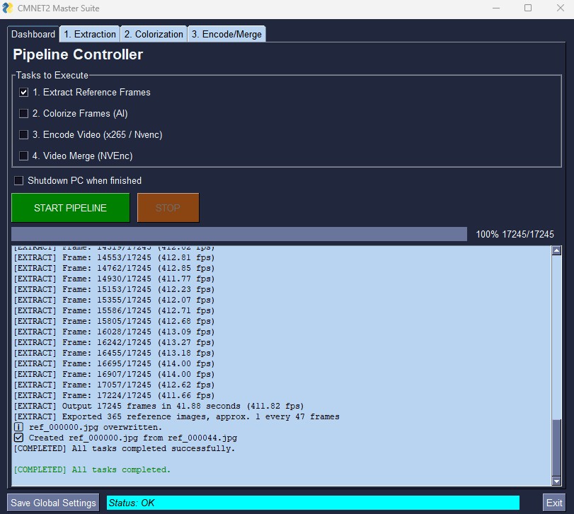

  The GUI has 4 tasks (the last is optional and suitable only if is used in input a clip already colorized).
   [Image: attachment.php?aid=3637]
   You can skip the first task and generate the reference frames using other external tools. It is only necessary to assign them the right name (ref_nnnnnn.jpg) and put them in the folder called "ref_tht10". Then you can start the colorization using Qwen-IE.

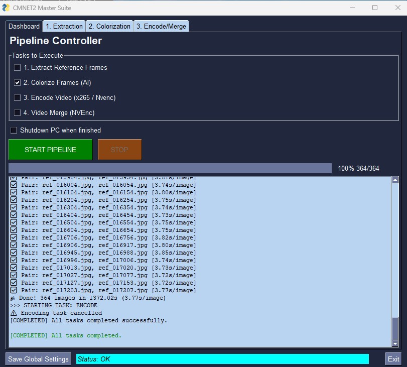

   [Image: attachment.php?aid=3638]
    Having split the pipeline in independent tasks will provide more flexibility. After the colorization you can check the colored frames and eventually adjust them.
    Finally you can run the full clip colorization using CMNET2 by running the task #3.
