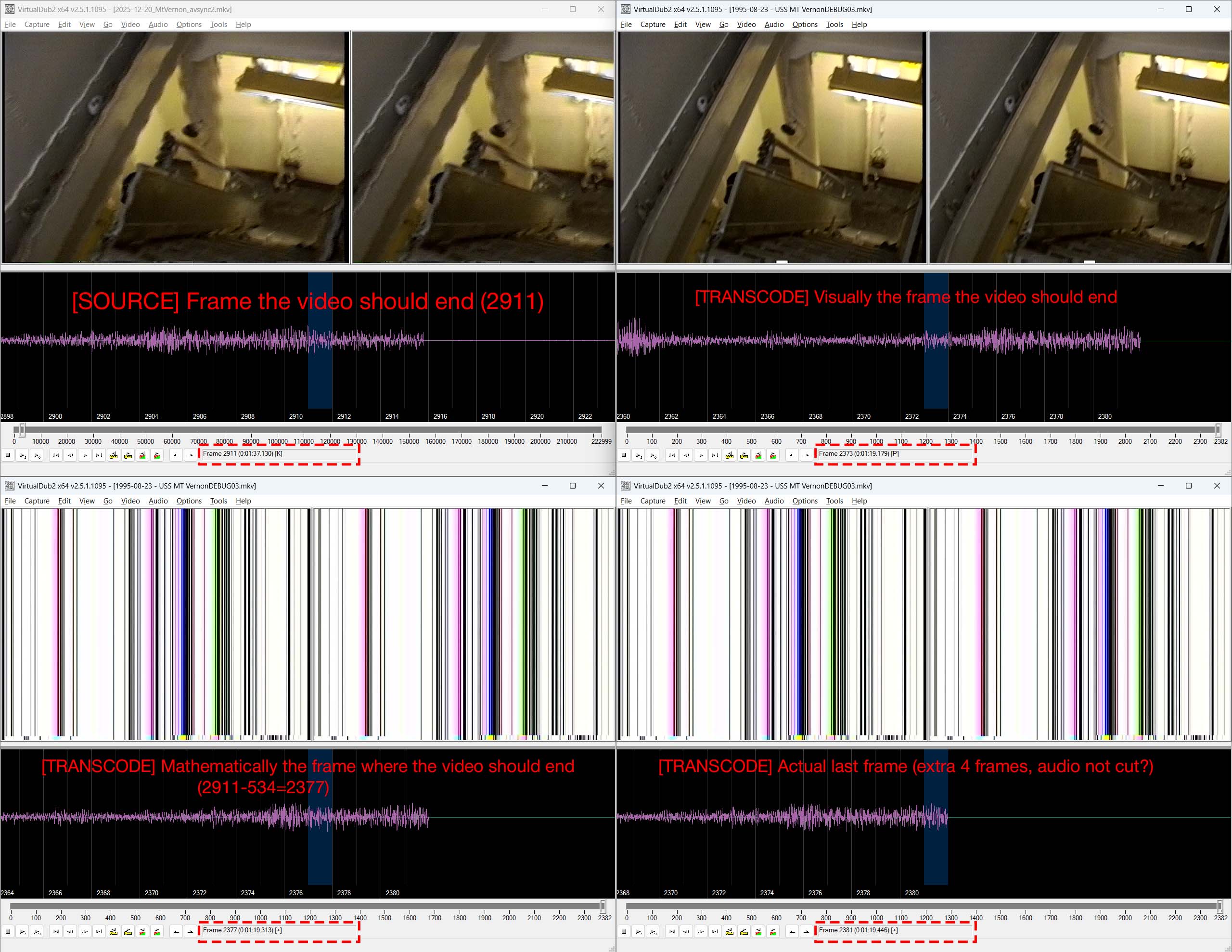

Whenever I attempt to transcode a range of video using frame selection it always includes a few extra frames at the tail end of the source, while also seemingly temporally compressing it so that over the course of the video once an equivalent amount of frames in the source and transcode have played they become out of sync. The frame ranges themselves have been selected quite precisely and verified in both VirtualDub and Premiere Pro, so I'm certain I'm inputting the correct in and out points. No speed change settings are enabled to my knowledge.
Additionally, upon transcoding said videos the audio becomes out of sync, starting around five frames too late.

I tried to cut a shorter source clip via MKVToolNix as a sample but somehow the transcode of that resulted in a video track that was double the length of the specified range, but let me know if you'd like the original file as a sample and I can PM it. In the meantime I've attached an image detailing the issue.

I really appreciate the detailed response, thanks to you I've been able to figure it all out! Upon viewing the Vapoursynth Preview I noticed the total frame count was 4 frames shorter than what VirtualDub/Premiere reports, and after running my source through ffprobe I discovered it had four duplicate frames, each one of them within the range I was testing the encode on :| . After accounting for the removal of those in my audio stream everything works as expected.
