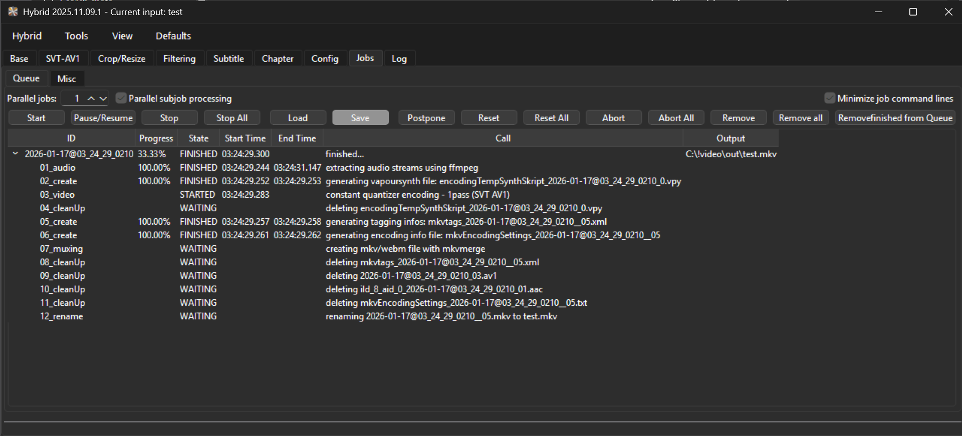

I encode using SVT-AV1. When I start a job status bar remain blank. I'm unable to track encoding process. The encoding itself runs normal.
I tried x264 and status bar has encoding status, so I assume it is SVT-AV1 encoder problem.
I would greatly appreciate if you could fix this. Thanks in advance. I attached debug log and screenshot.
Hybrid version 2025.11.09.1.
.7z   HybridDebugOutput.7z (Size: 55,18 KB / Downloads: 139)
