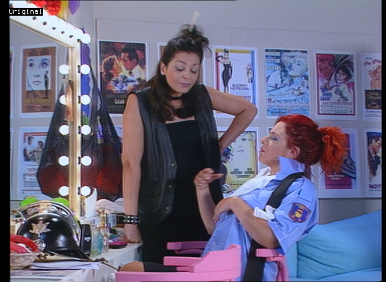

Hello there is this clip that has extreme halos and I want to fix it but dehalo doesn't completely do it justice. what would be the best options to fix it? the posters especially are the biggest problem

No clue, it looks like an interlaced source was improper resized and deinterlaced. (+ chroma wasn't 4:4:4)
If this isn't your actual source, you are probably out of luck.
(blurring is probably the only way to handle this)

Using the sample cut.
Here's what happens if you enable: "Filtering->Vapoursynth->Misc->Script->Lower res. before deinterlace" and set to 360x576, bilinear (and add CAS later).
Look at the posters in the background.
=> you might want to check your processing chain

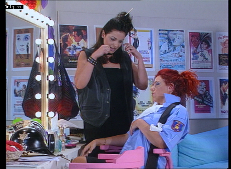

shows that now DeHalo can help:
