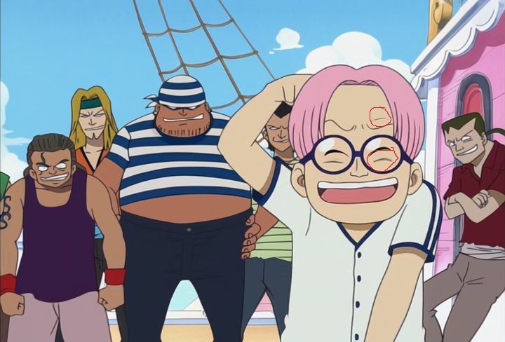

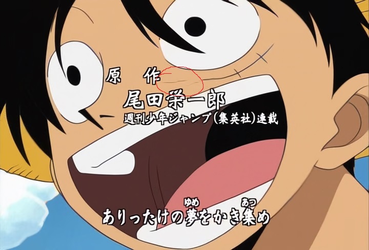

The QTGMC Input 3 method works well overall. However, on some scenes it sometimes creates black line artifacts (I’ve attached a screenshot for reference).

For QTGMC:
That doesn't really look like something I would associate with QTGMC, but
a. try Input mode 2
b. try whether using another 'source matching' value helps

When I use QTGMC, this is the issue I run into. However, you can see that it does remove the flickering on the boat’s ropes.

ReduceFlicker(clip, strength=3, aggressive=1) seems to work fine with the flickering.
This
script seemed to
work fine for me.
Filters I used are:
- TIVTC for the combing
- ReduceFlicker for the flickering
- Crop for the black bars
- Checkmate for some of the dot crawlers (especially on the right side of the frame)
- RainbowSmooth for the rainbows
- (edge masked) BasicVSR++ to fix the general edges
- LumaSharpen to emphasize the edges
- YAHR to lessen the white halos
- Resized to 1:1 PAR
- Santiang to remove staircasing artifacts on edges.
There are still rainbows in a few frames, but nothing that annoys me.
