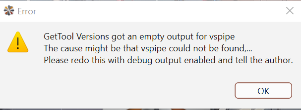

[HELP] vsvipe error
1- Hybrid_dev_2026.06.18-193220
2- VapoursynthR77_torch_2026.06.16
3- vs-mlrt_2026.06.06
[Image: hm8wb53.png]
I'm getting this error during installation.
VapoursynthR73_torch_2026.03.26    I'm not getting any errors in this version, but I'm getting errors in the new version. Can you fix it? Or can you explain how to do it?
Quote:I'm getting this error during installation.
I don't see how this could come during installation. If it was on the first start, and you didn't deinstall you old Hybrid install that is probably the cause.
This probably happens if you somehow fixed different Vapoursynth versions.
VapoursynthR73 vs VapoursynthR77 <- tons of stuff was changed between those.
=> Deinstall Hybrid (no need to delete setting, but profiles&co will have to be loaded and resaved if you want to keep them).
Then Install dev and add-ons.
https://forum.selur.net/thread-4383-post...l#pid29545
I saw your message in this thread. I downloaded and installed it immediately, and the problem was solved. The program opened, thank you very much.
