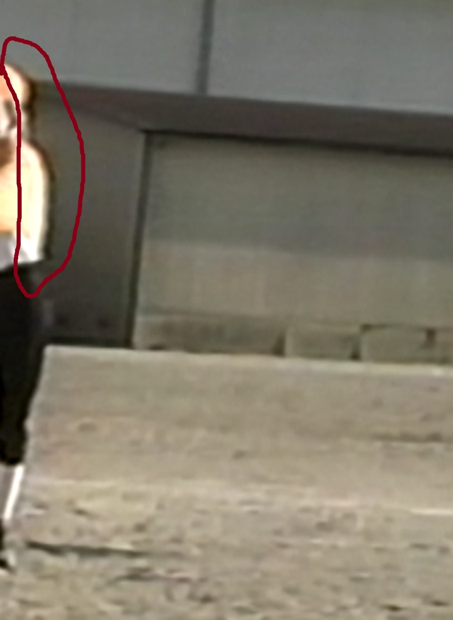

I have one video that has what appears to be luma/contrast artifacts in various scenes. The bright sunlight on a figure who is in front of a medium background produces a heavy black line between the brightly lit figure and the background. It is not a huge deal but if I could find a filter that would fix some of it, that would be great. I have tried nearly every vapoursynth filter. The best result I've had is from DeHalo_Alpha though it adds blur to an already blurry old video and only modestly lightens the dark line. I have attached one example screenshot with a red line around the area in question. This is after deinterlacing the video with vapoursynth though the artifact is also in the interlaced version. I have not applied any filters to the screenshot.
Thoughts on this?
DeHalo_Alpha would be the first thing I would try. (you got both bright and dark halos)
I can look at it if you can share link (i.e. mediafire, googledrive,..) a short sample of the unprocessed source. (like you would feed it to Hybrid, so not deinterlaced or otherwise filtered)
Ps.: BlindDehalo restricted with some EdgeMask is another approach I would try.
PPs.: you might also want to move the dehalo filters further up the filter order.
