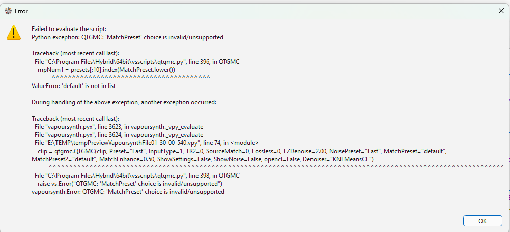

Hello,
I get the following errors when i enable "qtgmc"
[Image: Screenshot-2026-06-23-013040.png]
2026-06-23 01:30:01.464 Plugin C:/Program Files/Hybrid/64bit/Vapoursynth/Lib/site-packages/vapoursynth/plugins2/vsnlm_ispc.dll is using API3 which is deprecated and will be removed shortly. Plugin C:/Program Files/Hybrid/64bit/vsfilters/DenoiseFilter/NEO_FFT3DFilter/neo-fft3d.dll is using API3 which is deprecated and will be removed shortly. Plugin C:/Program Files/Hybrid/64bit/vsfilters/DenoiseFilter/DFTTest/DFTTest.dll is using API3 which is deprecated and will be removed shortly. Plugin C:/Program Files/Hybrid/64bit/vsfilters/ResizeFilter/nnedi3/NNEDI3CL.dll is using API3 which is deprecated and will be removed shortly. 2026-06-23 01:30:02.064 Failed to evaluate the script: Python exception: QTGMC: 'MatchPreset' choice is invalid/unsupported Traceback (most recent call last): File "C:\Program Files\Hybrid\64bit\vsscripts\qtgmc.py", line 396, in QTGMC mpNum1 = presets[:10].index(MatchPreset.lower()) ^^^^^^^^^^^^^^^^^^^^^^^^^^^^^^^^^^^^^^^ ValueError: 'default' is not in list During handling of the above exception, another exception occurred: Traceback (most recent call last): File "vapoursynth.pyx", line 3623, in vapoursynth._vpy_evaluate File "vapoursynth.pyx", line 3624, in vapoursynth._vpy_evaluate File "E:\TEMP\tempPreviewVapoursynthFile01_30_00_540.vpy", line 74, in clip = qtgmc.QTGMC(clip, Preset="Fast", InputType=1, TR2=0, SourceMatch=0, Lossless=0, EZDenoise=2.00, NoisePreset="Fast", MatchPreset="default", MatchPreset2="default", MatchEnhance=0.50, ShowSettings=False, ShowNoise=False, opencl=False, Denoiser="KNLMeansCL") ^^^^^^^^^^^^^^^^^^^^^^^^^^^^^^^^^^^^^^^^^^^^^^^^^^^^^^^^^^^^^^^^^^^^^^^^^^^^^^^^^^^^^^^^^^^^^^^^^^^^^^^^^^^^^^^^^^^^^^^^^^^^^^^^^^^^^^^^^^^^^^^^^^^^^^^^^^^^^^^^^^^^^^^^^^^^^^^^^^^^^^^^^^^^^^^^^^^^^^^^^^^^^^^^^^^^^^^^^^^^^^^^^^^^^^^^^^^^^^^^^^^^^^^^^^^^^^^ File "C:\Program Files\Hybrid\64bit\vsscripts\qtgmc.py", line 398, in QTGMC raise vs.Error("QTGMC: 'MatchPreset' choice is invalid/unsupported") vapoursynth.Error: QTGMC: 'MatchPreset' choice is invalid/unsupported
Using Dev 2026.06.20.1 + Torch R77
Seems, like a bug when "Don't hide defaults" is enabled.
=> disable that and it should work
I also uploaded a new dev which should, even when "Don't hide defaults" is enabled, hide the 'default' value.
(23.06.2026, 03:49)Selur Wrote: Seems, like a bug when "Don't hide defaults" is enabled.

Hi Selur,
Unchecking that box in the script tab did the trick.
QTGMC is working properly again  Big Grin👌🏽
And, a global profile i have loaded enabled the setting.
Which is weird, because i know for a fact i never ever have enabled that setting in hybrid before.  So how could that have been saved to that profile in the  first place  Huh
Anyway, thanks for the new Dev.
no clue, the option was never enabled by default. Smile
