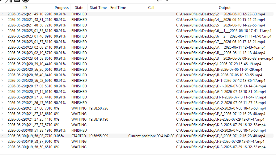

Can be nice (after ROCKHARZ ) to have some statistics on jobs queue
[Image: time.png]
if it's possible can be nice to have new columns....
one for the TIME spent on every job (without mentally process starting/ending values)
and MAYBE a column where is displayed a RATIO ( X ) about lenght of a clip (for example 1 hour vhs) compared to TIME USED to generate the processed file (MAYBE 30 min)
for example 1 hour of footage processed on 1 hour... mean 1X
and... 1 hour of footage processed on 30 min ... mean 2X (better to round to first decimal.... 2.4X 2.7x)
and... also if i can ask... but is not important... to save also these values on the JOBS view... because right now closing and reopening Hybrid... there are just FILENAMES, STATE.. and OUTPUT.   no datas about time.
P.S.... why a finished job is 90.91 % ?
I added a new column, which is filled in case start&end time are known.
Not sure whether I'll add support for remembering the times. (will think about it tomorrow, too groggy today)
the 90% happens if some sub-job either wasn't executed or didn't properly report back.
=> if you can share a (ideally short) step-by-step to reproduce the problem; then I can look at it (tomorrow).

i cutted a piece on video to provide a sample.. but with this cutted piece teh job is reaching 100% ... (?)
