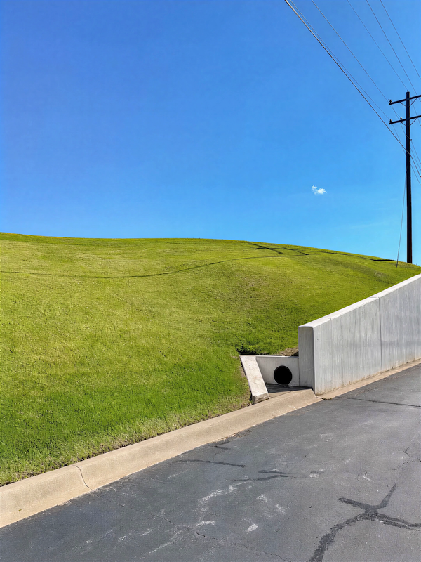

Here is the shift that I had:
The above is an animated PNG. It shows the original frame capture for 1 second, then the frame capture output from Hybrid using the above workflow for 1 second, then repeats.
It is *not* that noticeable, however, it *is* incorrect. Look closely at the green grass and you will see it shift to a slightly more yellow shade. The blue sky also shifts, although it is not as immediately noticeable as the green grass shift, at least for me.
The AI (in this case, ChatGPT 5.6 Sol at the Pro reasoning level, which is the current highest) determined that the image is actually shifting from FCC → SMPTE 240M instead of from Rec.601 → Rec.709.
This is because the sorayuki build back in February 2018 added Rec.2020 support, but did so incorrectly. Adding Rec.2020 changed the total supported matrices from four to five. However, its constructor was never changed to multiply by five. Therefore, its results were skewed:
https://rentry.co/97vkywpq
I tested this in Vapoursynth: I did a color matrix conversion from FCC → SMPTE 240M, and the same frame showed the exact same color shift that is happening when doing a color matrix conversion from Rec.601 → Rec.709 in AviSynth, which seems to confirm what the AI determined.
