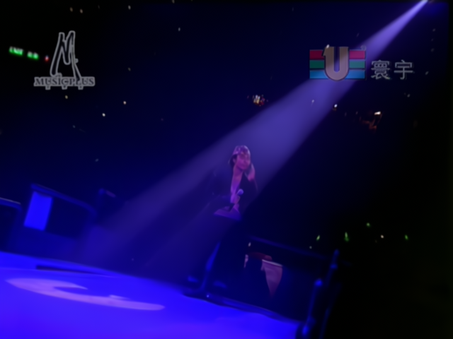

I've attached a short clip showing the problem. I processed the DVD source with BasicVSR++ using length=15 and length=150. In both cases, pay close attention to the mist/fog in the background – you'll see noticeable jumps at regular intervals.

Looking at your encode:
Frame with index 149 => 150
I see the problem, BasicVSR++ is too aggressive, due to the low resolution. 704x480 with PAR 10:11 is 640x480 or 704x528 depending on how you compensate the PAR.
Only way around that is to feed it a higher resolution video. BasicVSR++ is less aggressive on higher resolution input. Wink
Using BasicVSR++ ( "BasicVSRPP(clip, model=4, length=150)" with FP16), but telling Hybrid beforehand to resize width&height by a factor of 2 (lower values might also work; you probably will have to test). Not knowing what your goal is, I let Hybrid downscale afterward. (Controls for this are only visible if "Filtering->Vapoursynth->Misc->UI->Show 'Gimmick'-controls" is enabled)
Frame with index 149 => 150:
