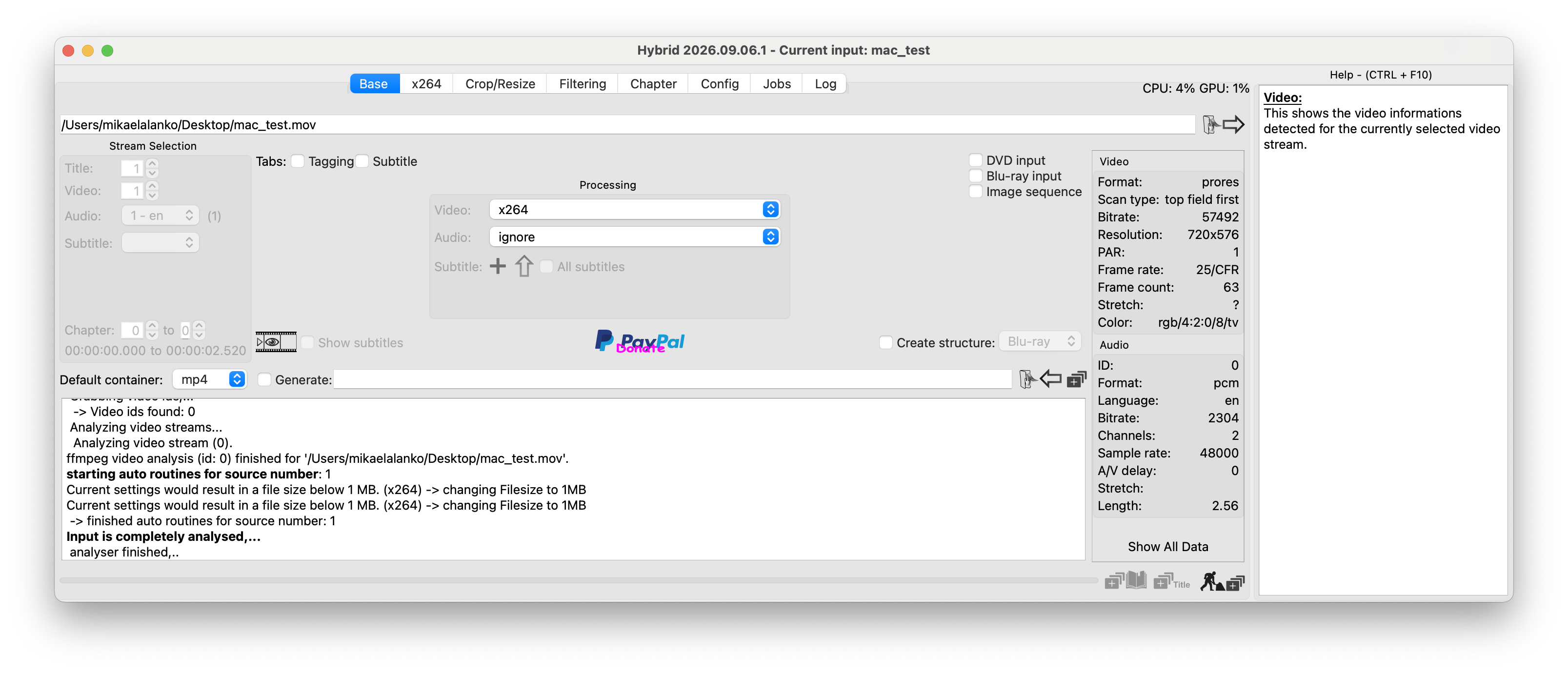

When I load a 10-bit Apple ProRes 422 HQ .mov file (PAL 720x576, 25fps, Top Field First), Hybrid displays this under the Video info on the Base tab:
Color: rgb/4:2:0/8/tv
Under Show All Data, the XML shows:
  • Color Space: rgb
  • Color: 4:2:0
  • Bit depth: 8

Hello again!
When loading a 10-bit ProRes 422 HQ interlaced .mov on macOS (Hybrid 2026.08.21.1 ARM64), the file gets treated as rgb/4:2:0/8, which triggers an unwanted RGB24 -> YUV444P8 conversion before QTGMC and washes out contrast.

Okay, this also happens with the latest dev on mac os (not on Windows or Linux).
=> I'm looking at it an will report back.

It is an issue with the parser that parses the ffmpeg analysis output. (parser fails and rgb is used as fallback)
=> working on it
Thank you for confirming and looking into it! Really appreciate your help.
Uploaded a new dev version, which seems to fix the problem here.
Let me know whether that version, fixes the problem for you too.
Thank you so much! The new build completely fixed the issue. The file is now correctly identified as YUV422P10, and that unwanted RGB conversion before QTGMC is completely gone. Contrast and black levels are now preserved perfectly.
