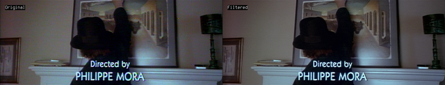

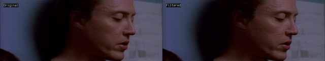

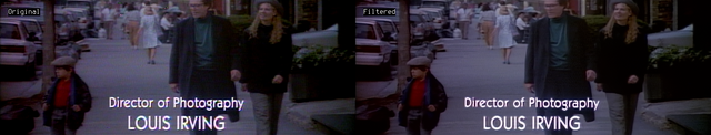

My LaserDisc of
Communion has light-to-medium laser rot on the image. Here are unprocessed samples from
side one and
side two.
While I want to preserve a high degree of detail and texture, I would like to eliminate the little video sparkles and short/thin horizontal black lines, which fortunately are not wide scratches.

Looking at sample 1:
a. source was resized and probably sharpened during capturing :/ (not sure the aspect ratio is quite right, but I ignore that)
b. source is not progressive but probably field shifted (this capturing setting were bad)
c. it has tons of noise
had a quick look at sample 2, has similar issues.
What I would start with:
- overwrite the input scan type to 'field shifted' (this will cause Hybrid ot use TFM)
- use QTGMC as denoiser for with input type 2 <- will remove residual combing after the field matching.
- use Composite for rainbow removal
- use SpotLess with Temporal Radius 2 <- this is for the 'sparks'
- Crop the black bars
then I would enable Retinex to better see the problems and look at denoising, dehalo, color adjustments,... maybe some stabilization (i.e. Temporalfix),...
not really tuned:
https://pastebin.com/mpCp2ia2
You could also add something like DetailSharpen (but then Composite refine should be used with 0 to avoid too much sharpening), which I would then move before Spotless. There seems to be a slight chroma shift (x=1.25)
Assuming the capture is as good as you can manage, the above should give some ideas, but you should decide how much denoising&co you want,.. there are tons of screws and fitlers you can try.
