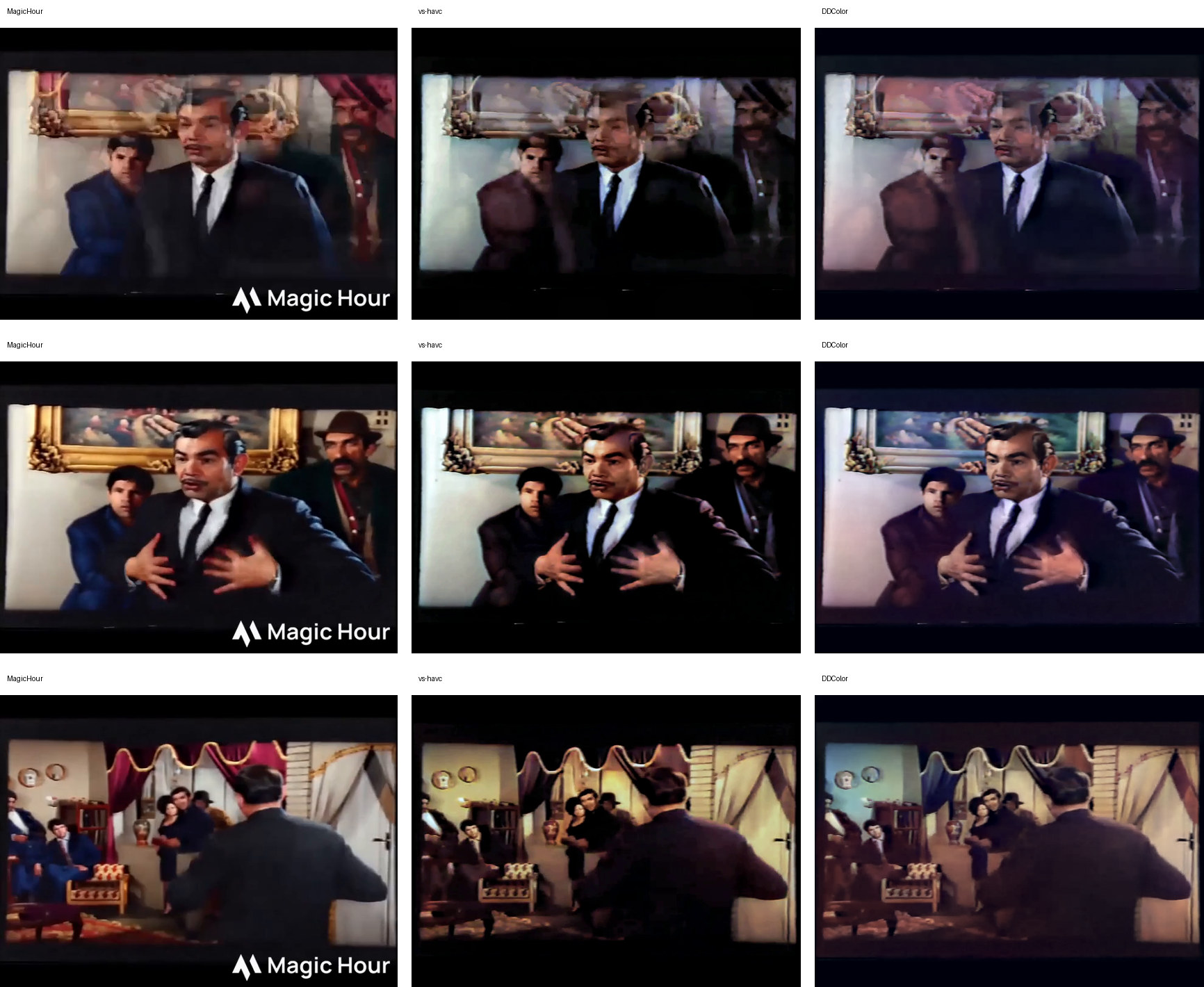

Update: I now have all three on the SAME indoor scene, so the comparison is fair this time. Attached screenshot shows MagicHour vs vs-havc (your ch. 4.0.1 low-GPU settings) vs plain DDColor, 3 frames each.
Honest take: vs-havc and plain DDColor are basically tied — both get the gold picture frame, the maroon curtain and the blue suit wrong, while MagicHour nails all three. So vs-havc didn't move the needle for me vs DDColor.

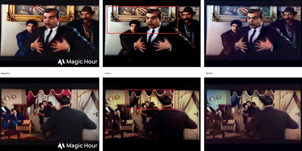

Hello,
  to me havc is much better than DDColor alone (see details in the red rectangle)
  [Image: attachment.php?aid=3759]
  havc colors are more stable and this is an important feature for video colorization.

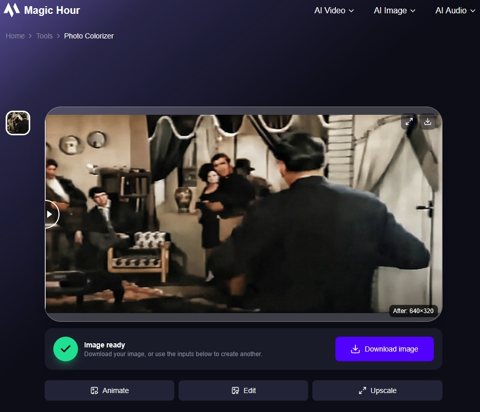

  Moreover you are not comparing apple-with-apple, Magic Hour is a cloud service and behind they are using powerful GPUs using probably DiT models.
  I tried to colorize a frame with MH but the result was quite bad (washed colors)
  [Image: attachment.php?aid=3760]
  probably you provided to MH a clip with better quality and resolution.

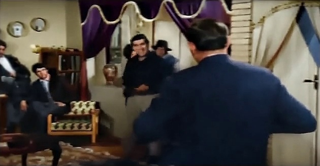

  In this release I added support to FLUX2 Klein 4b/9b.
  Klein 4b is smaller than LongCat Q3 (7.6 GB of weights against 8.8 GB, and 3.8 GB against 5.8 GB in the text-encoder phase) and, is faster than LongCat.
  Try it (it works well even with 2 steps).
   I attached the clip colorized with Klein 4b (2 steps).
.zip   havc-klein-4b_indoor_3s.zip (Size: 271,21 KB / Downloads: 42)

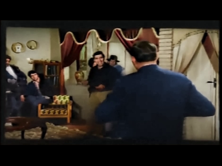

Three things puzzle me:
1. Your clip is only 630x328, mine is 940x704, yet yours looks cleaner and more vivid. Is that just the smaller scale hiding softness, or is something different in your render (steps, settings, post-processing)?
2. Yours has NO color bleed/spread at all — the colors sit exactly inside their objects. Mine is softer, with slight bleed. Could that be the compiled correlation kernel vs my PyTorch fallback, or a propagation setting?
3. Your curtains came out purple; mine are red/burgundy (and in an earlier letterboxed run they were even brownish). Same film, same model. Is that pure seed variance, or do you set something (prompt tweak, color option) that pushes such decisions?
Stills from shot B attached (yours vs mine). Any hint is appreciated — my goal is to reproduce your result 1:1.
