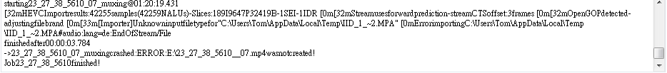

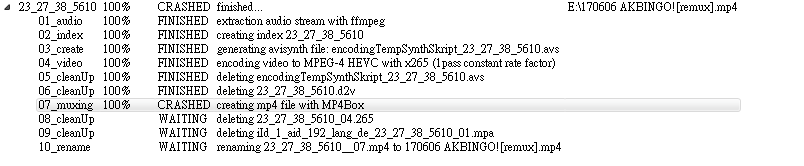

I had an error occured when encoding a TS file video to mp4 video.
I prepared a debug file as well and I hope that the problem of which can be found and solve later.

Judging by the debug output the decoder crashed..
This can have multiple causes:
  • a buggy source, since your source if mpeg2 and a transportstream I guess it's a buggy capture of something. (most likely)
    -> running the source through ProjectX or other tools meant to fix mpeg2 video inside transportstreams might help
  • Avisynth script might run out of memory (less likely)
    -> try enabling 'Filtering->Avisynth->Misc->Misc->Disable MT'
  • something is interfering with the decoding (even less likely)
    -> try disabling firewall/antivirus suits
