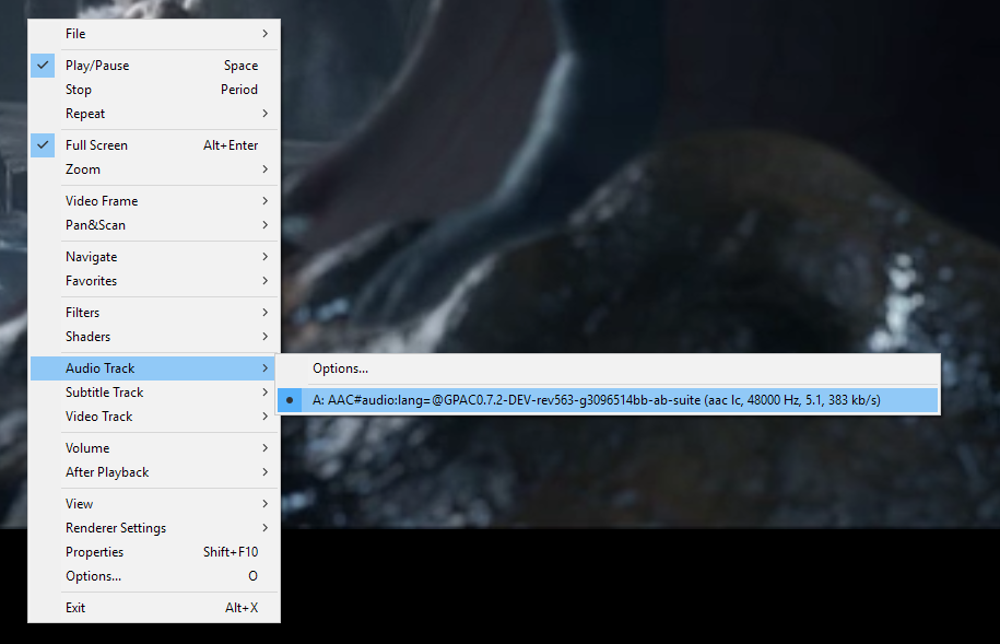

Soundhandler: Sounds like you also installed ffdshow and that is also used inside MPC HC.
Looking at the muxing call:
Quote: "D:\Programs\Hybrid\64bit\MP4Box.exe" -add "G:\PLEXME~1\NEWTHI~1\ERAGON~1\13_12_~1.MP4" -add "C:\Users\mapsk\AppData\Local\Temp\IID_1_~3.AAC"#audio:name="Main Audio":lang="en" -mpeg4 -add "C:\Users\mapsk\AppData\Local\Temp\IID_2_~4.AC3"#audio:name="Secondary Audio":lang="en" -chap "C:\Users\mapsk\AppData\Local\Temp\13_12_35_0210__13.chp" -itags tool="Hybrid 2018.07.27.1" -tmp "C:\Users\mapsk\AppData\Local\Temp" -new "G:\PLEX Media\New Things To Sort\Eragon (2006)\13_12_35_0210__14.mp4"
Only two audio tracks are added, so the Soundhandler is something that is added due to your playback configuration.

(06.08.2018, 05:31)Selur Wrote: Soundhandler: Sounds like you also installed ffdshow and that is also used inside MPC HC.
I do have MPC-HC installed, but I've never seen Sound handler before in any of these 1,000+ movies and shows I've ripped, the first time I have ever seen it is when I did those same five tests with the .mp4 file.  So is this something MPC-HC most likely installed by itself, and is it somehow interfering with Hybrid?
#23
No. Ist's not interfering with Hybrid.
Ist's triggered by one of the settings in MPC HC, or ffdshow. This dies not happem here and I'm pretty sure that there is no additional audio track added by Hybrid.
-> this looks to me like something triggered by some setting in your setup during playback.

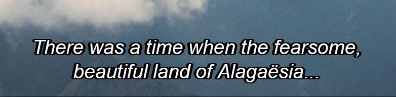

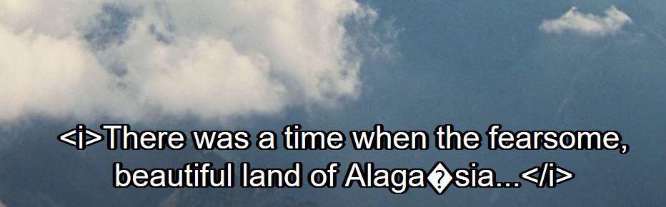

One last question for now, it appears when I add subtitles (.srt file) and make an .mkv, the output file shows a .srt file when played, but when using the same file and converting to .mp4, it seems to convert it to .ttxt (Mov_text) I think.  Is it possible in Hybrid, to have an .mp4 output file, and the .srt subtitles in the stream?  It is causing things like the <i> / </i> not being recognized as italics.  If so, how specifically do I set that up in Hybrid, and why is it doing it?  See screenshots for examples.  The First one shows the .mp4, and displaying incorrectly, but shows as using MOV_TEXT.  The second one shows the MKV, using the same exact subtitle file, but showing correctly, and being listed as the .srt file.  Please help me understand what to do to fix this, if it is possible.

And here is one of the restrictions of mp4:
It does not support .srt, .ass and .pgs subtitles.
It does only support ttxt and idx/sub. And support die those two is also rather sparse in players.
So to keep content compatible Hybrid converts srt to ttxt (removing formating iirc).
As aside note: the inital srt specification also does not support HTML styling tags.
If you want styled subtitles with mp4 you can:
a. embed/hardcode the subtitles
b. convert the subtitles to idx/sub
c. place the subtitles next to the file in a separate File.

Yes, mp4 does not support srt.
ttxt does support italic and some other simple effect, see: https://gpac.wp.imt.fr/mp4box/ttxt-forma...mentation/
Hybrid dos simply remove all html tags since most players I encountered to not support them and instead of showing bold content as:
content they would show
